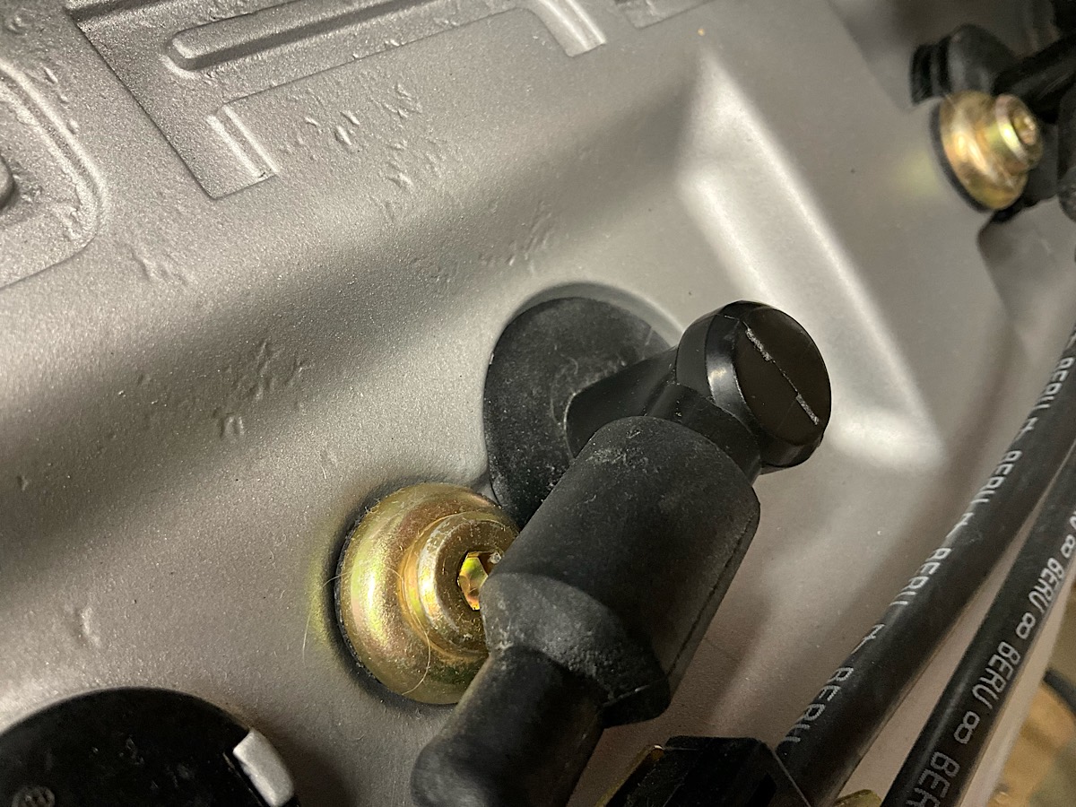

Giddyupp wrote: Mon Jul 08, 2024 2:02 pm Im assuming I should push them in until they bottom out, could you please confirm.
You should, literally, hear a “click” when the plug boots are properly seated. Absent that, the top of weather boot should be below the level of the cam cover.

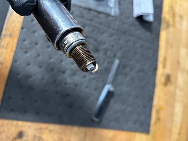

Fnally got a few hours on the car again yesterday. Pulled all the plugs (which are new) checked the gaps (.028") and torqued them all to 18Ftlbs. Though the plugs are new they have been run on several test runs for probably at least 10 miles yet they all looked absolutely spotless. (not sure if this is an indication of anything).
Next I installed all the leads, confirming they are pushed firmly down onto each plug per the photo above. Then checked them all the way back to each distributor to confirm correct firing order. They are new Beru leads with the cylinder numbers right on them so it's kind of easy to confirm. I then pulled both leads off the coils, confirmed I was using the correct version and re installed making sure they are pushed all the way in on both ends of each coil.

Ok. Plugs and wires double-checked.
Driveable with MAS unplugged is half-fairytale. Idle, sure. Driving? Not so much.
Plugs are fine. You need more than a few minutes of idling about for them to show anything unless something is very wrong or it’s a top-fuel dragster.
I assume all plugs looked more-or-less like the one shown above.

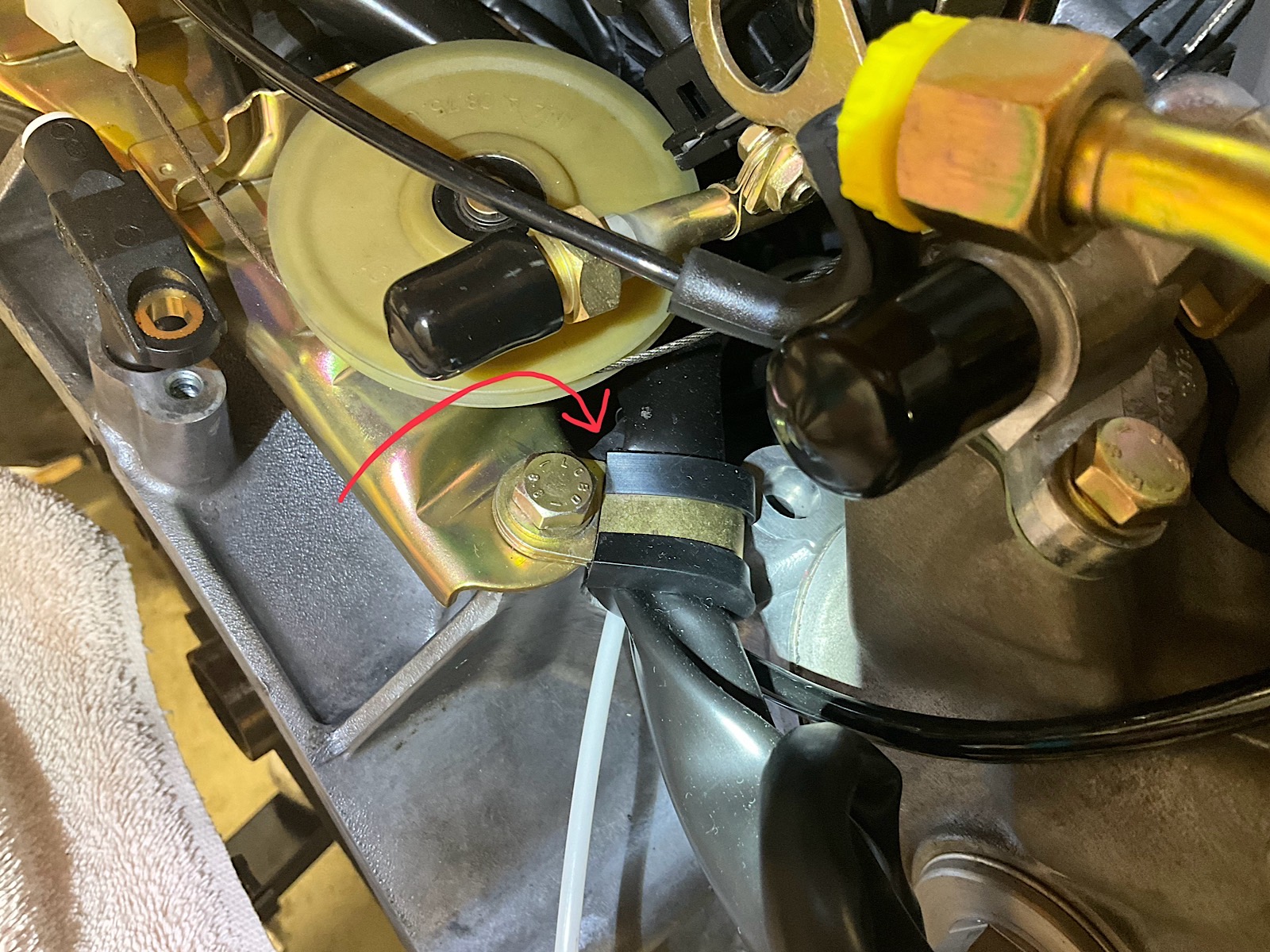

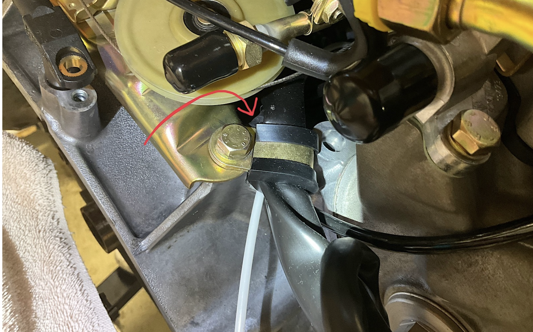

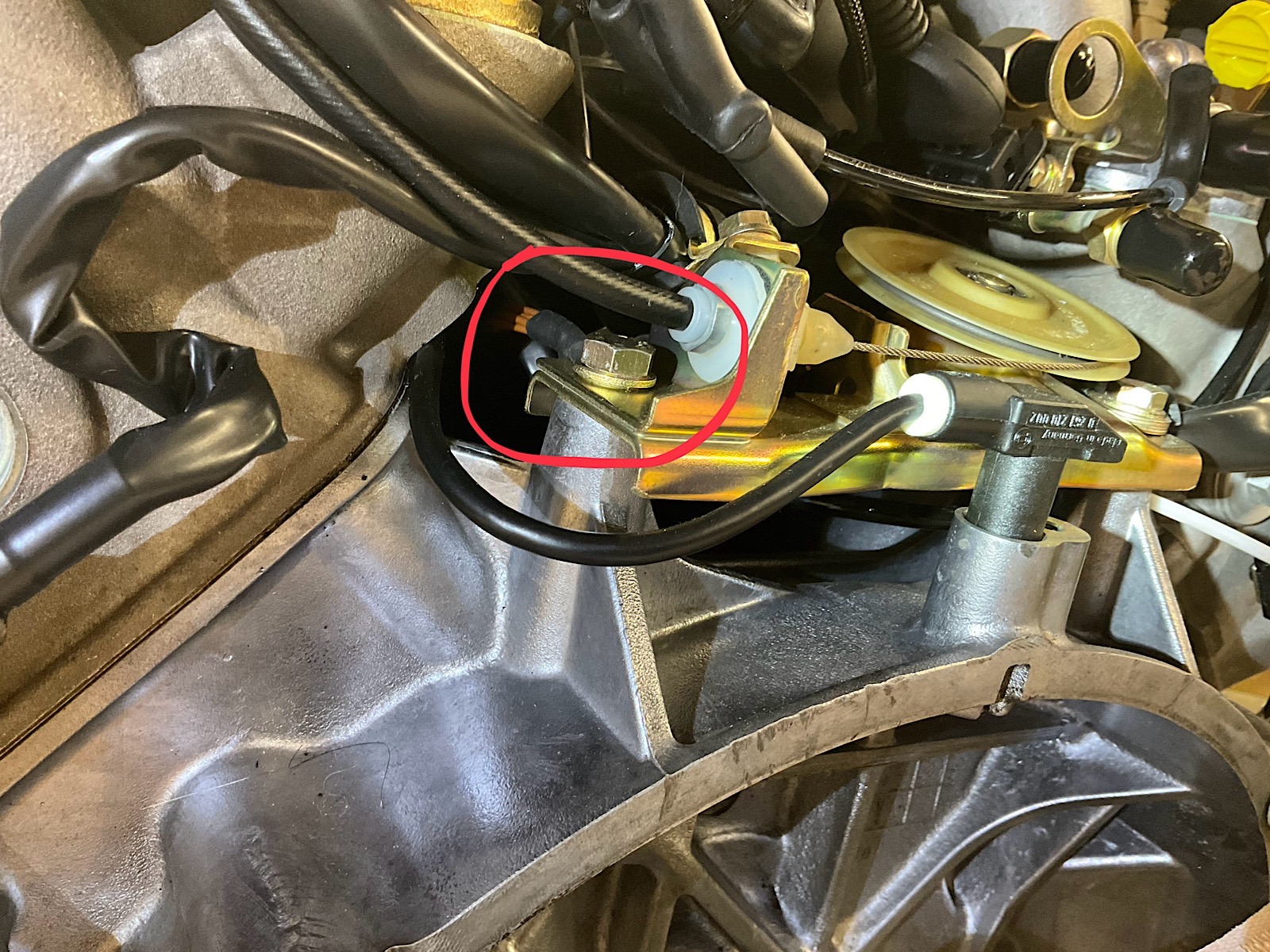

#272759
Giddyupp wrote: Tue Jul 16, 2024 1:39 pm You used the word Grounds (plural). As far as I can see there is only the one ground wire back there and yes it was removed, cleaned and reinstalled. Have I missed a wire ? should there be more than one ? If so a photo would be much appreciated
Pictures below.
But, before that, what means do you have to test/observe spark? Timing light? Oscilloscope? Anything?
There are two ground points. One for EZK and stuff(*), and one for LH and stuff.
(*) I don’t have the wiring diagrams memorized.
Whichever one you messed with, make sure the bolt is not loose.
Whichever one you didn’t mess with, observe its condition. Unless you removed its bolt, the bolt is unlikely to be loose. But, you can check its tightness to be sure. Cleaning it, while maybe a good idea, is unlikely to solve this problem. *if* the ground is the problem it’s because the bolt is loose or the terminal is hanging on by one strand of copper.
The obvious ground:
The not-obvious ground terminal is hidden under the P-clamp for the LH harness. It may be difficult to observe its condition without a small inspection mirror. If you unbolted the cable pulley console during your refresh then definitely make sure it’s where it is supposed to be. The arrow points to the shrink wrap for the terminal:

#273343
:jumper: :jumper: :jumper: :jumper: :jumper: :jumper:
That was it - Wow I just can't believe it. I had loosened the passenger side bolt that holds the main harness to give me some extra access (had no idea there was a ground wire there).
I was checking all around per your advice and was literally about to give up again as I could not see the ground wire at all. It wasn't until I reached in to wiggle the harness that I saw it was extremely loose - I guess I never did it back up again after the top end refresh. Not really sure how it ran ok immediately after that - maybe the bolt has worked looser over time. It was completely loose with almost no thread hanging on. All tightened up and "viola" started right up - idle right around 800rpm (cold) - no poping at all. So happy - Reckon Ive be chasing this for 2-3 months now. Thank you so much for your help with this. won't get a chance to take for a drive for until tomorrow but I pretty confident thats it. Thankyou thank you thank you !

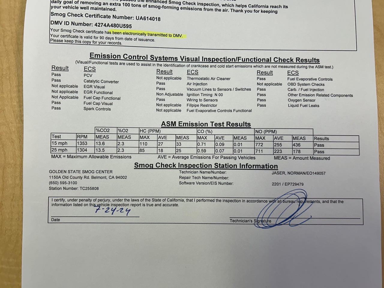

Im gonna call this a victory at this point. Been driving all week. Hot starts not a problem and no weird noises at idle. I just took her in for a Smog check and she passed no issues. thanks again for the help :beerchug:
