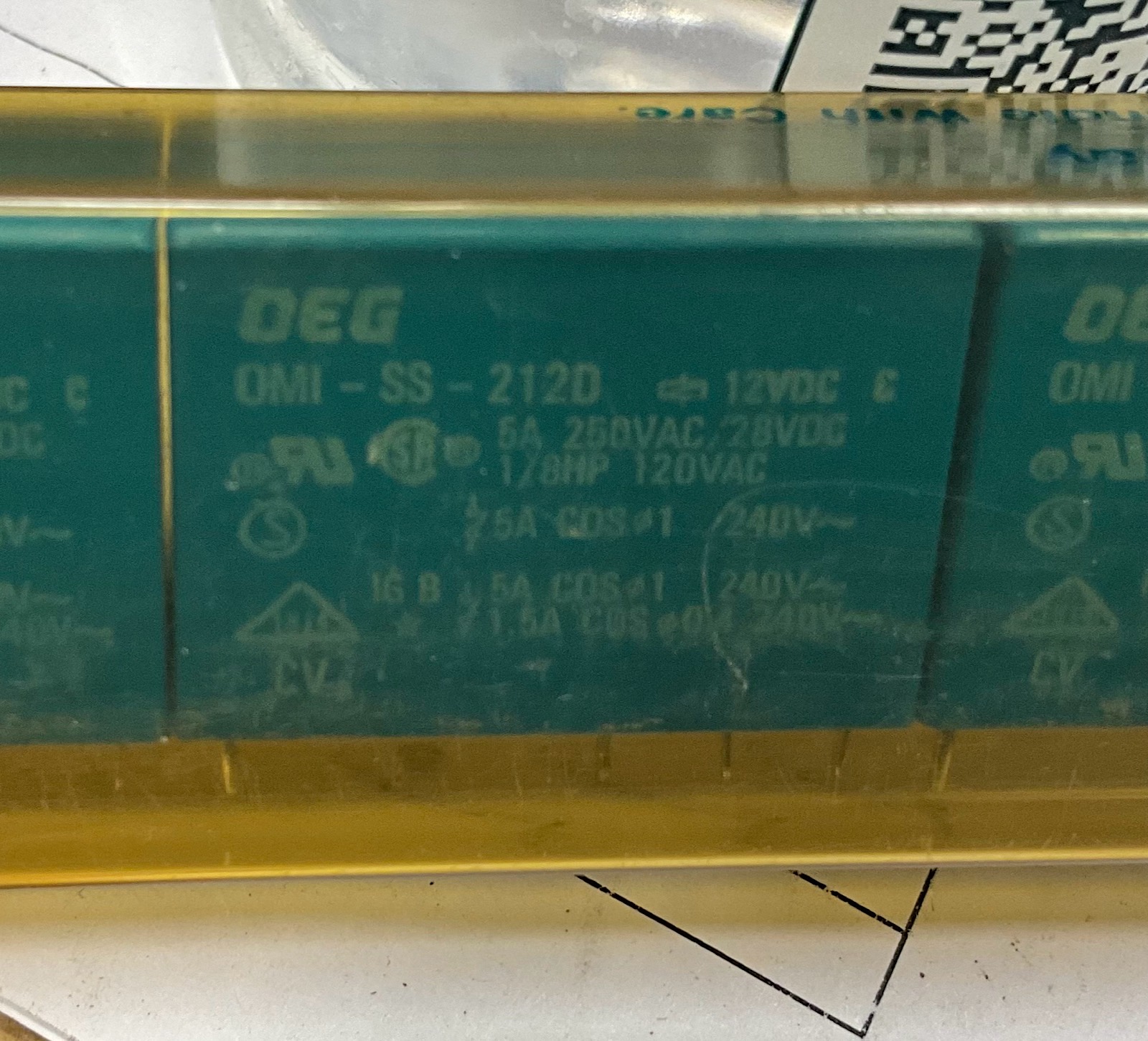

LSHK928 wrote: Wed Jul 24, 2024 7:52 pm The relay is the Gruner 970. The RL posts on the relay fix - on or off-board, are all quite old and show old Radio Shack parts (remember them?) Does anyone have a recommendation for a new "modern" relay replacement - on or off board?
I have a stick of these (see below) that I got on e-bay years ago, for whenever I decided to get good at soldering or rebuilders stopped rebuilding. Assuming your plate isn’t lying, you could hop down south of Nashua buy me a burger and I’ll give you one to mess with.
Plate is real. I am in Merrimack, near Nashua. Would love to meet-up for a 928 "play-date".
