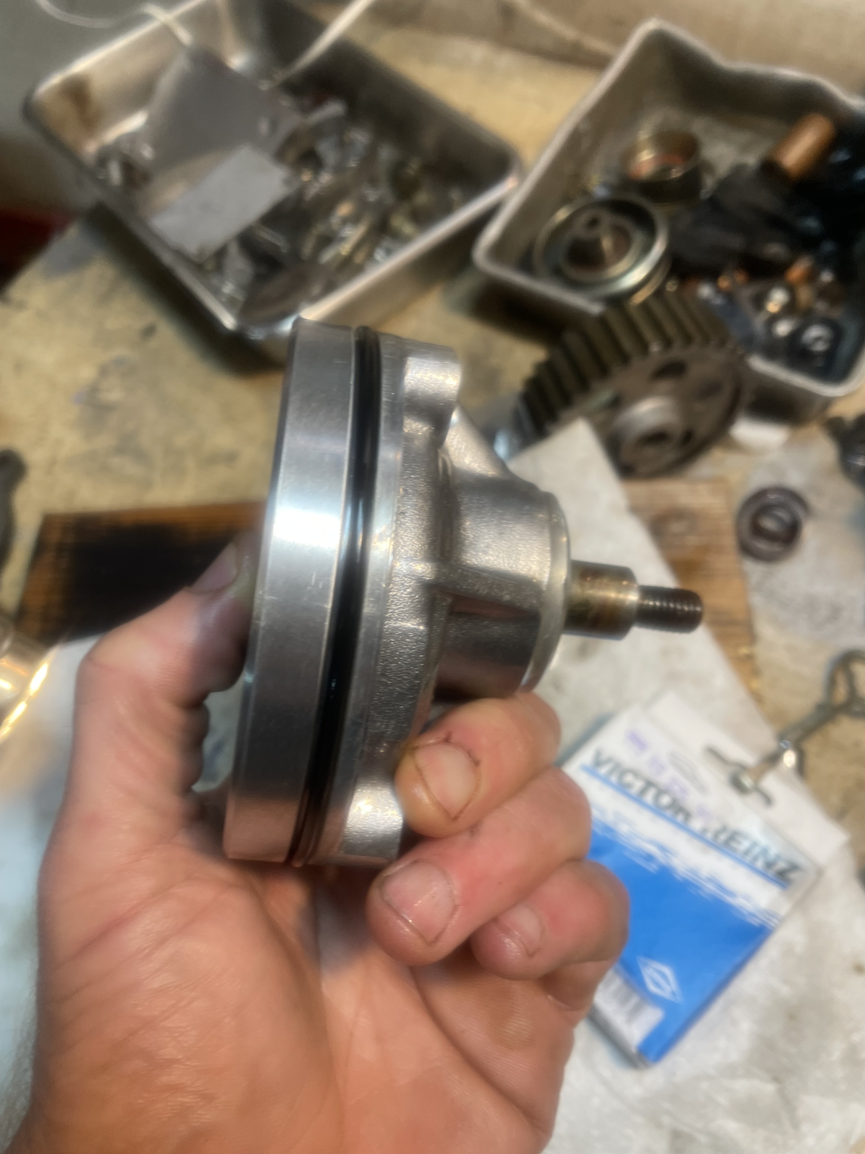

#331041
A little tricky to remove or just me?
It took a pretty big gear puller and lots of heat.
Original to car (MY 86).
Alloy. Not sure when steel versions superseded.
I was afraid I was going to crack it. No damage seen.

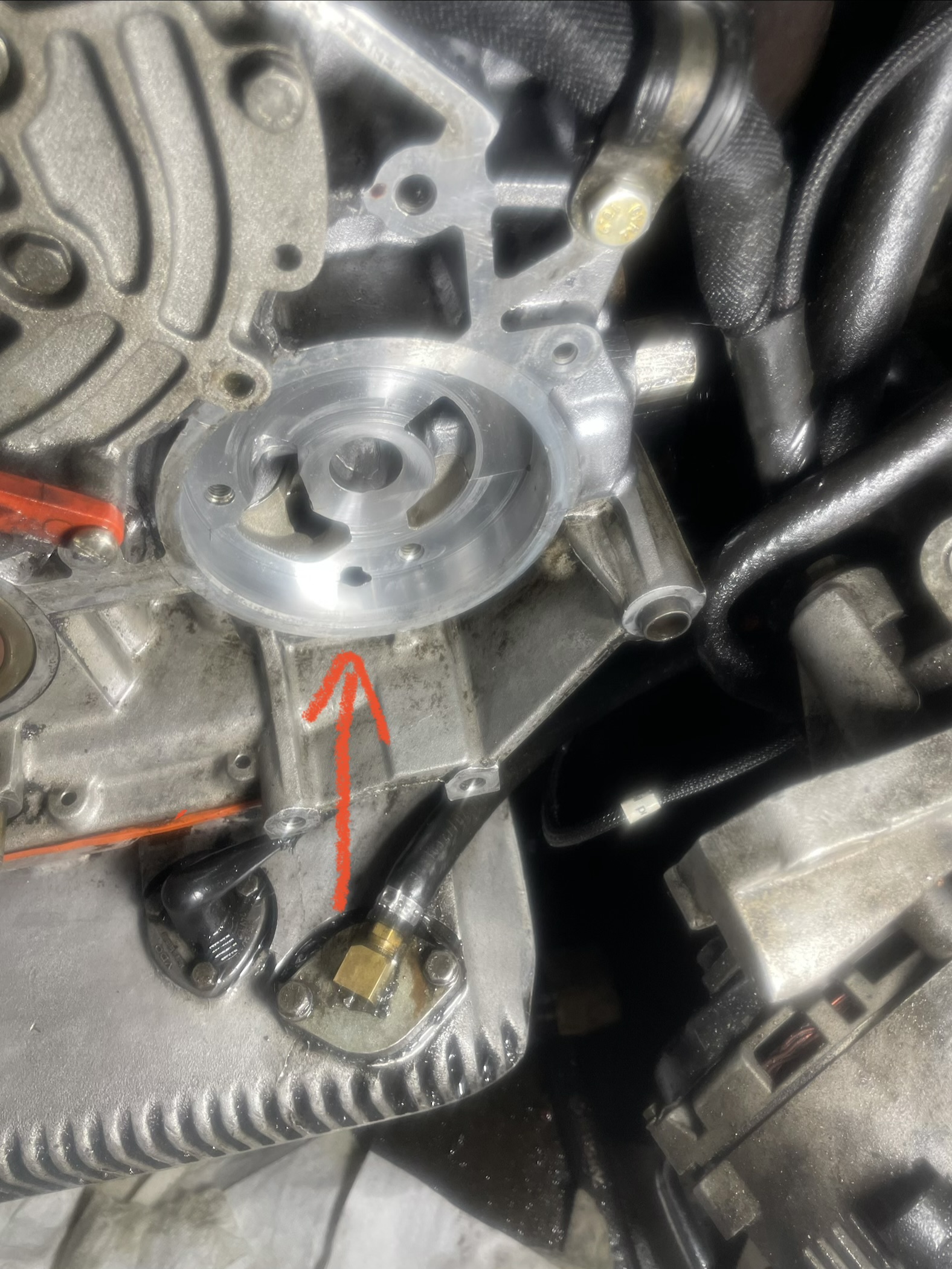

Just checking on what’s normal here.
The block has an irregular edge hole behind the oil pump.
I can’t discern if some flaking defect or previous abuse by someone, or standard issue?
Pump itself appears fine at that location. No leaks noted.

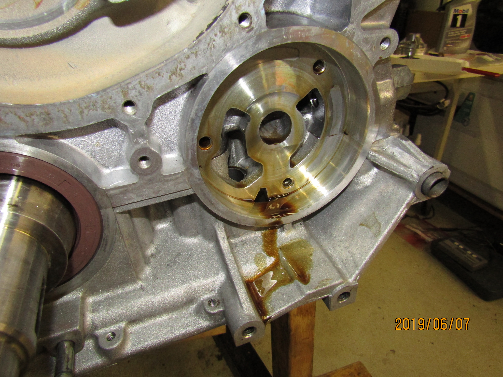

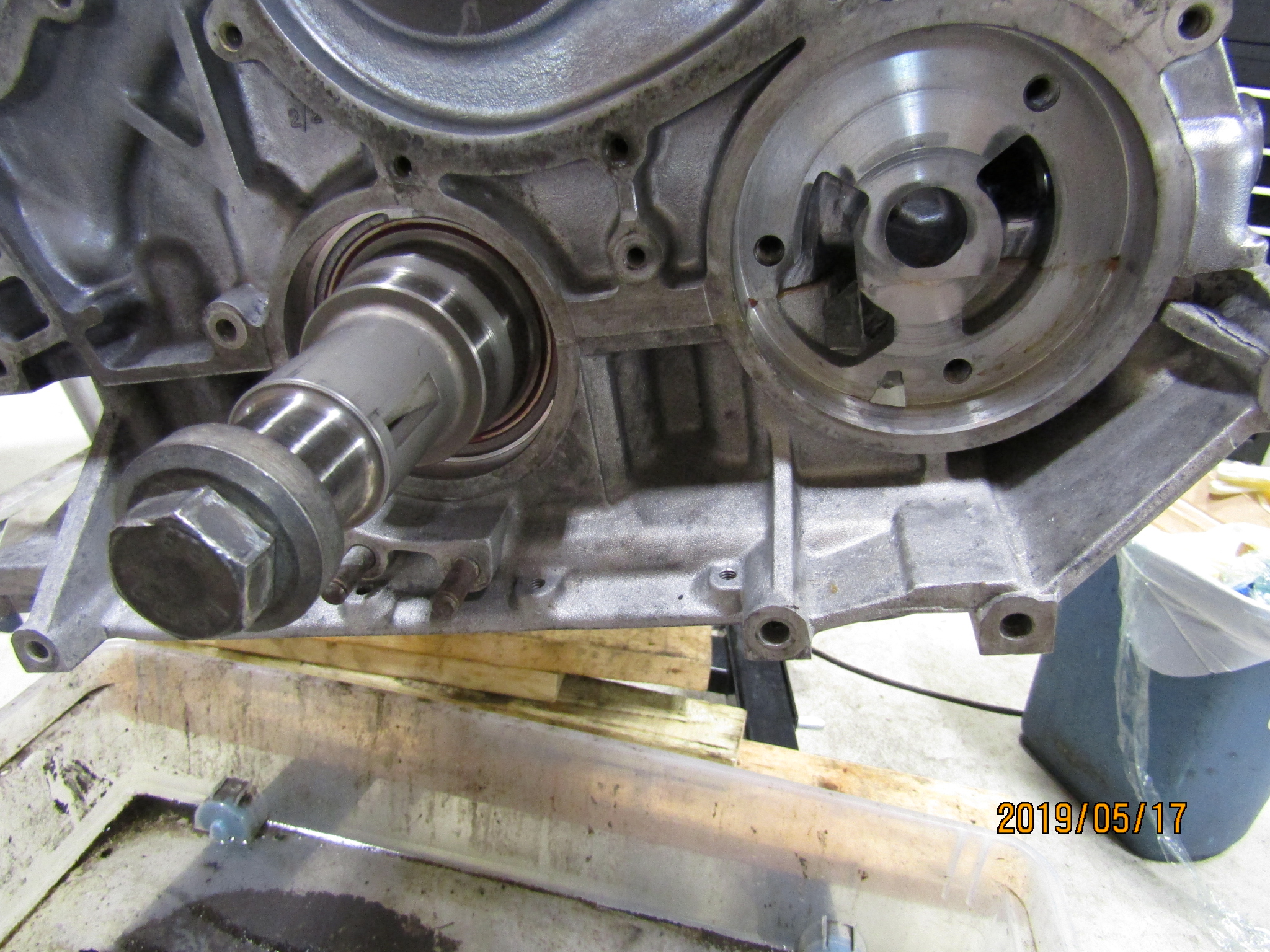

Yours looks like all the others.
The split between the cylinder block and the girdle goes right through the oil pump. It always looks a bit shitty.
Here, two different 928 engines:

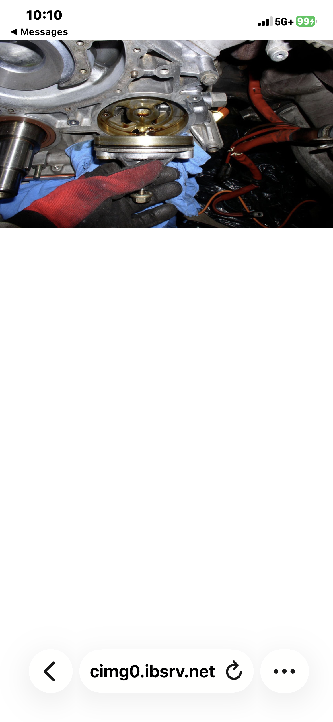

Thank you.
I found this image this morning too.
Just irregular enough to make me pucker last night.
