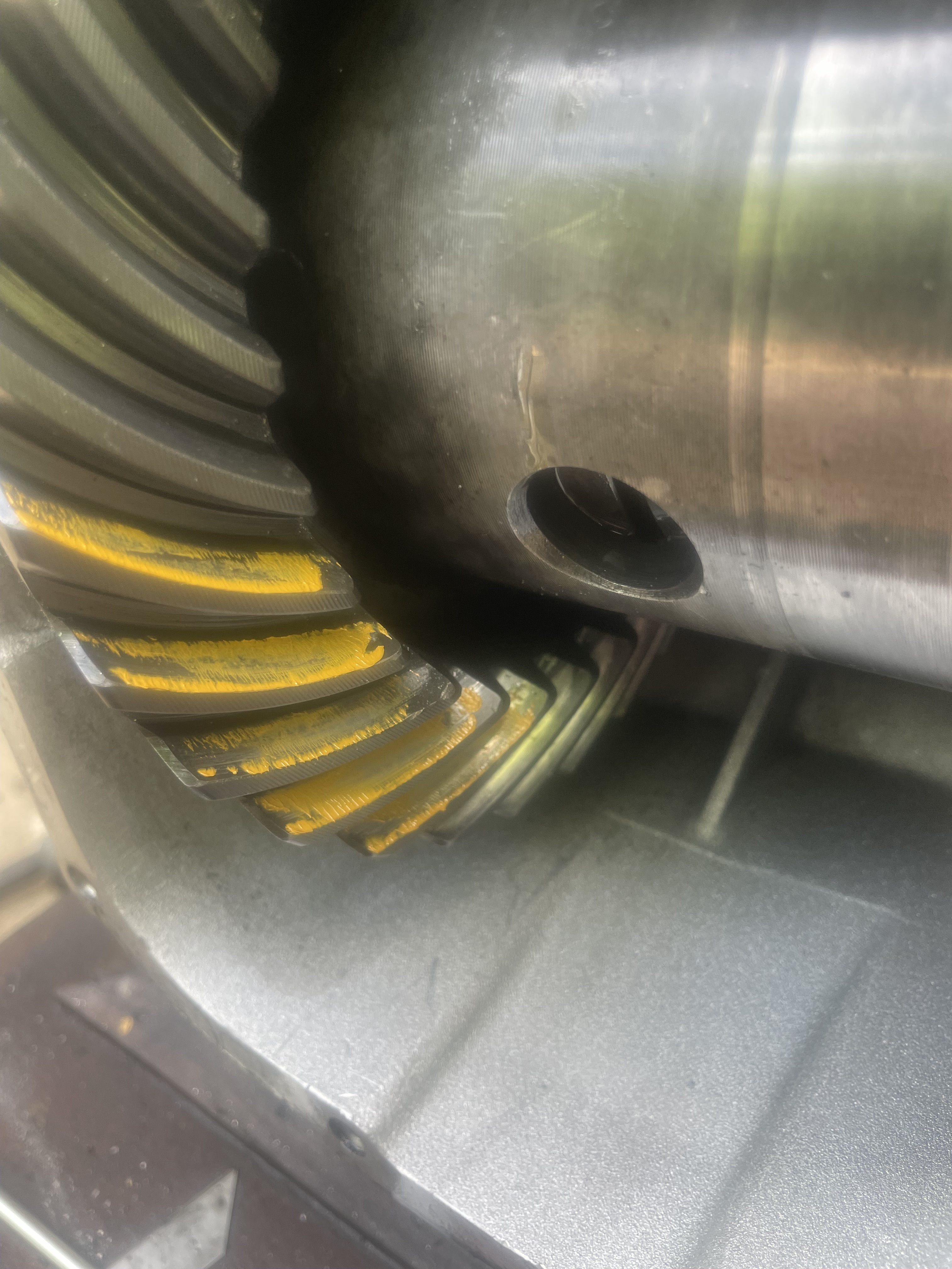

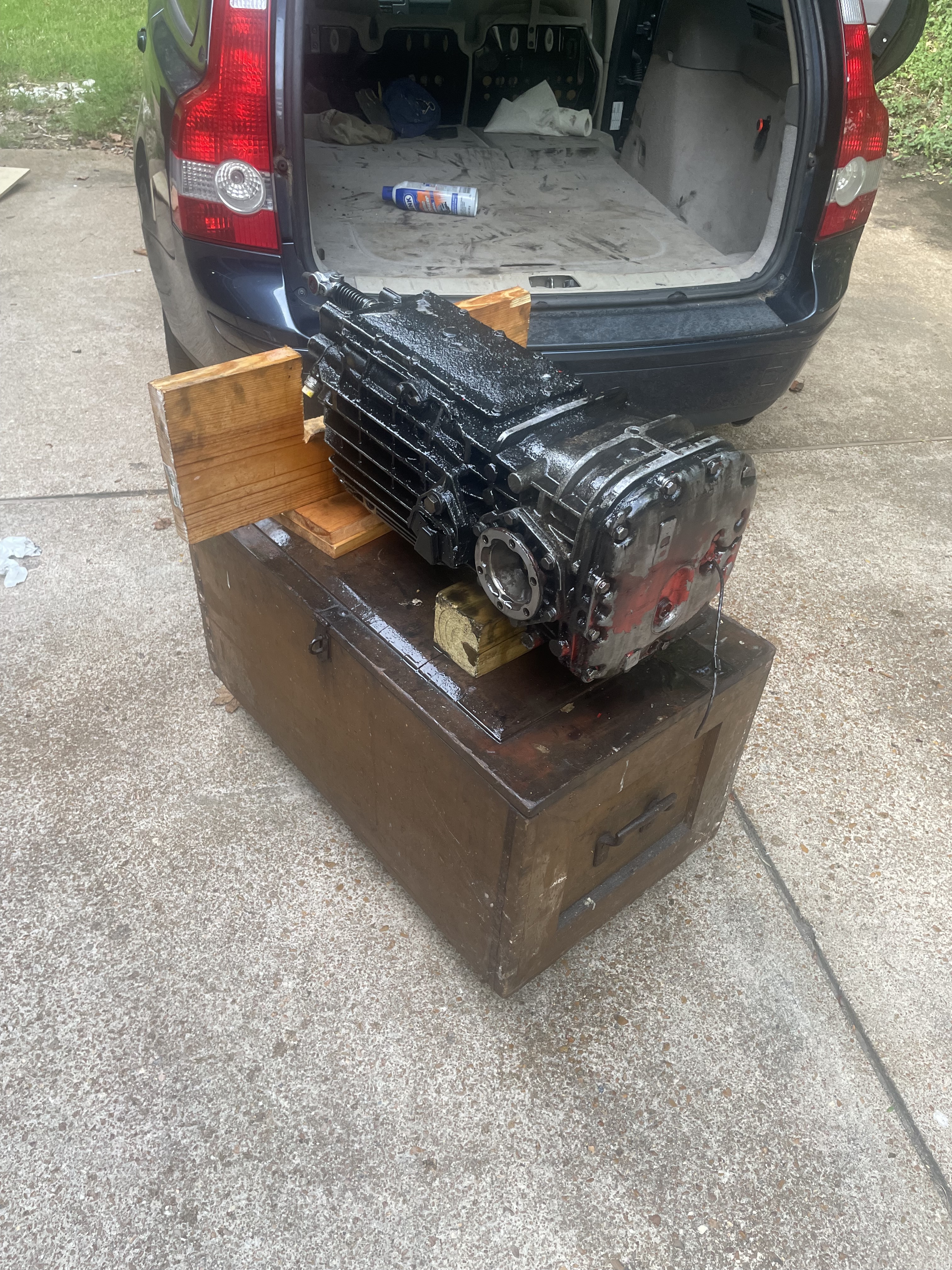

Unit arrived freight, in a pretty sorry state on the outside, but “ok” in general.
LS appears to have been sold by 928 intl. with ring gear stamped November 84.
My hunch was that it was done by a pro, simply playing odds that if set wrong it would be destroyed by now.
Gear compound looked ok for whatever that meant.

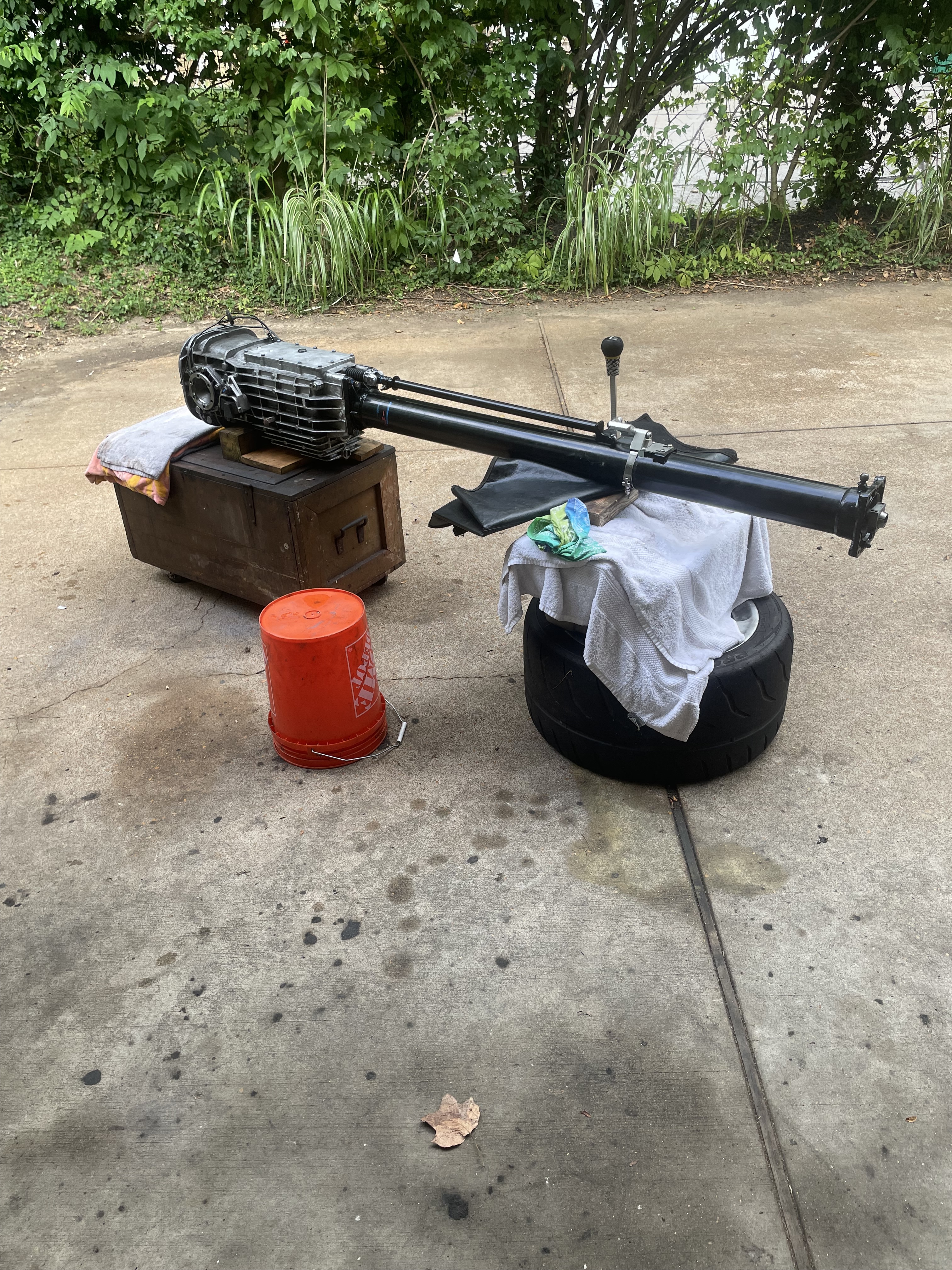

Cleaned up and mated with rebuilt TT.

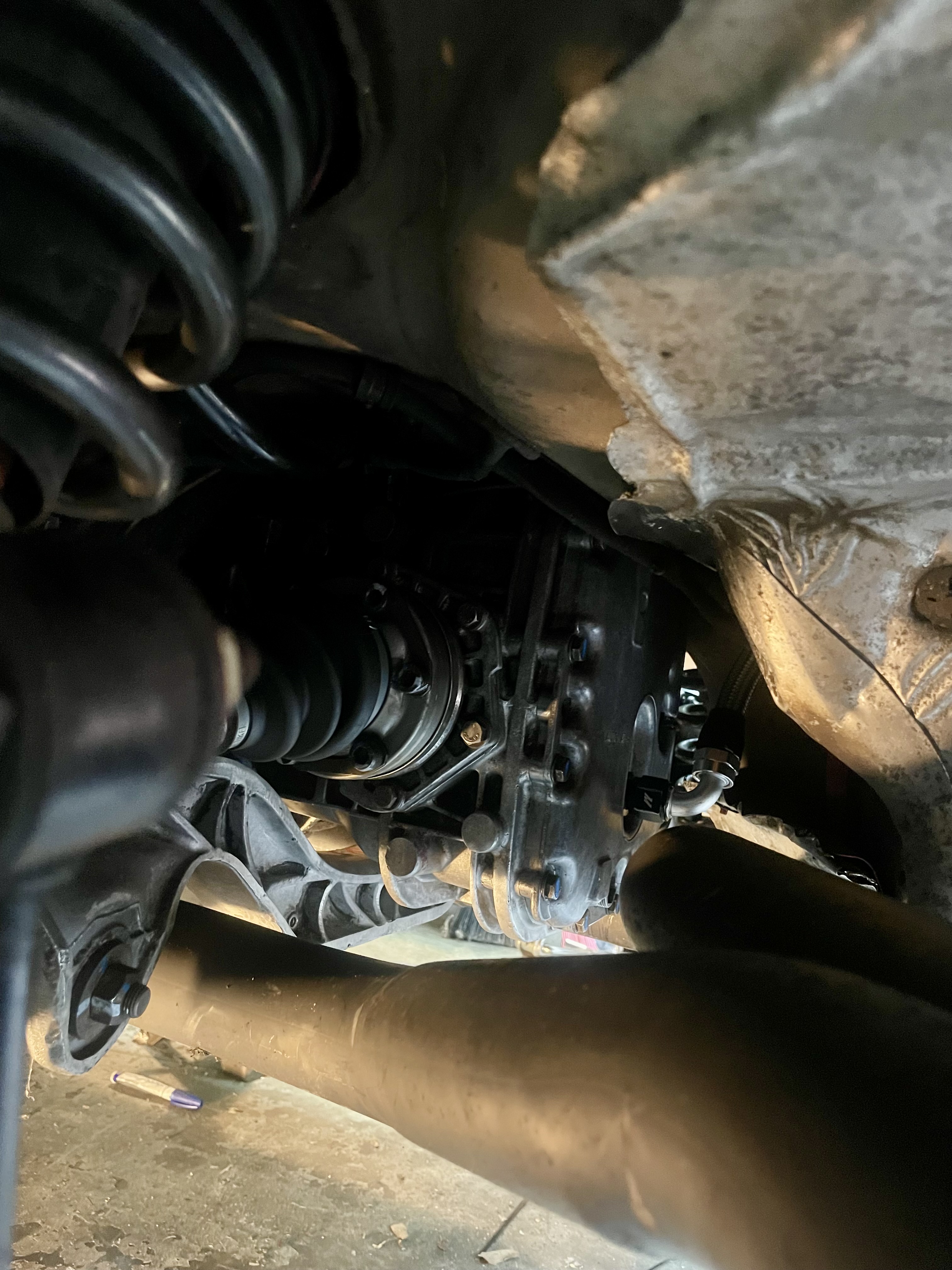

Mounted with transmission cooler:
Test drive last night. All seems well.

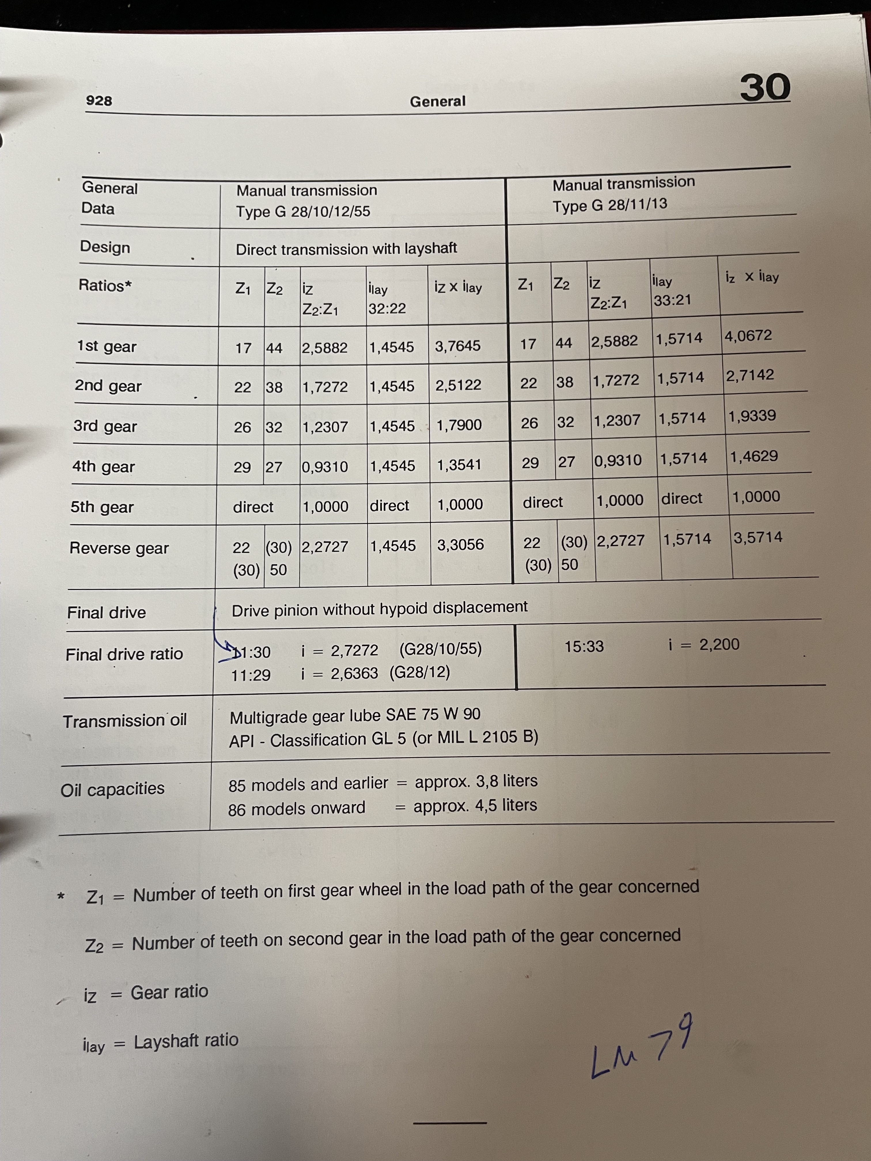

The differences:
Smaller volume case. I think about 500 ml. Not sure how, maybe more internal fins in the case. The case dimensions appear the same.
Larger plugs. The G28/10 has 24 mm fill plugs. As opposed to the 22 mm on the G28/11.
Geared lower. It didn’t look like much on spec sheets, but it really does change shift points. I don’t see it as an issue, but interesting. Maybe you guys can educate me on what Porsche was doing there. Maybe taller gears in US to promote higher top speed?
Shift pattern itself is slightly different.
Through previous trial and error, I set everything per WSM. Even with Hans’ link delete, I’m comparing apples to apples.
Reverse and first are further left. You still get smooth 1-2 without guessing, but 2-3 and 4-5 are more kinda stand alone H, overall. If that makes sense.
