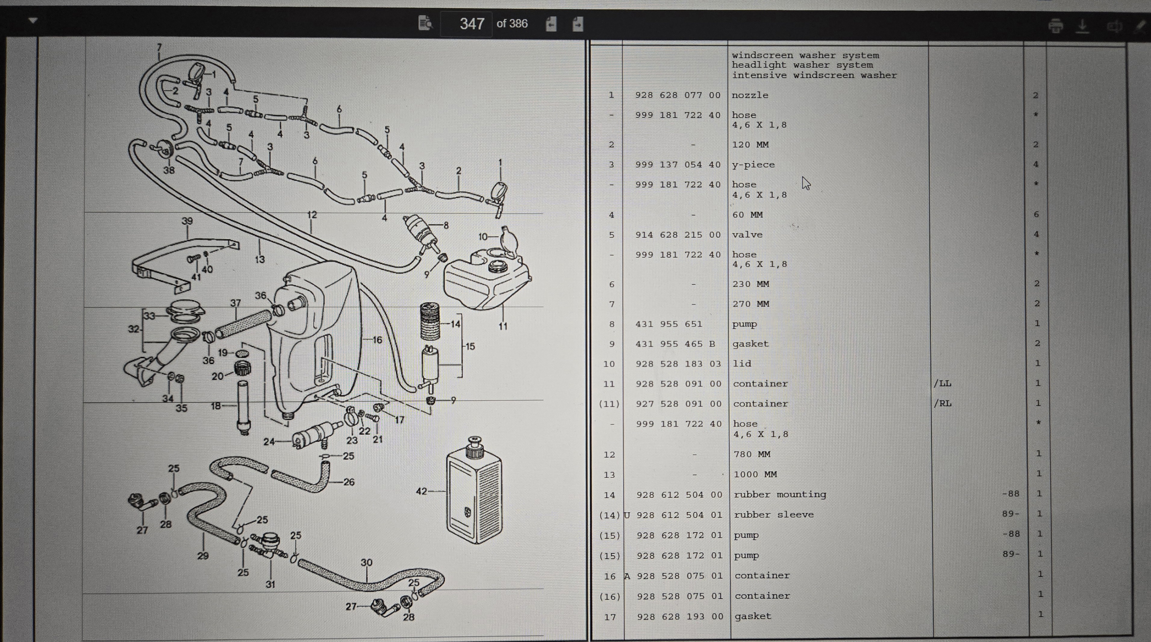

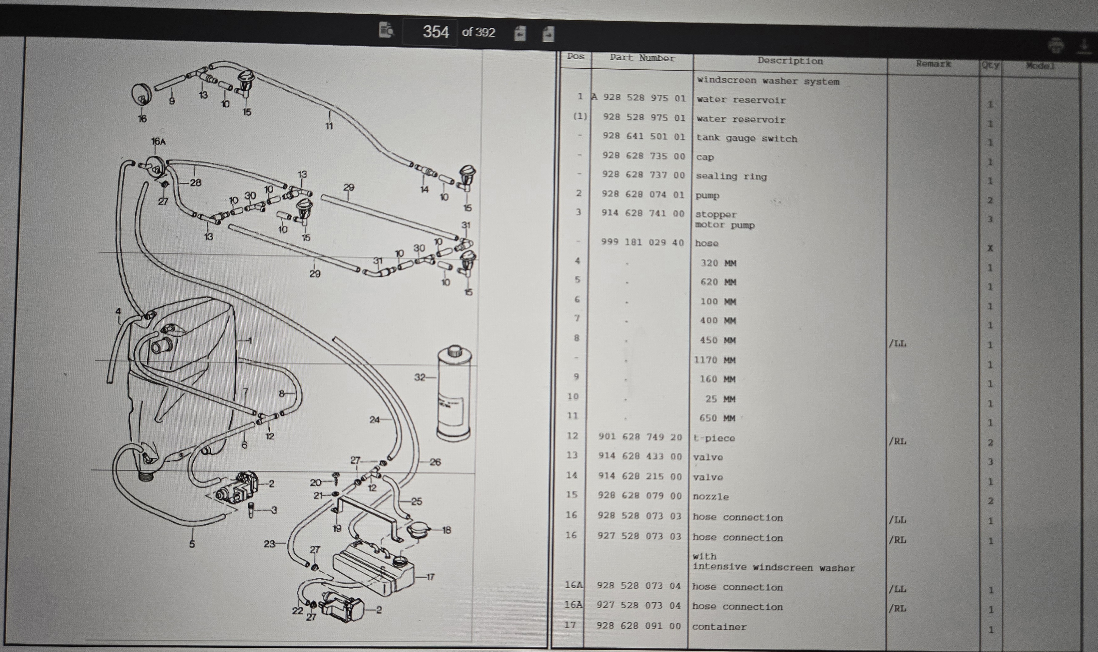

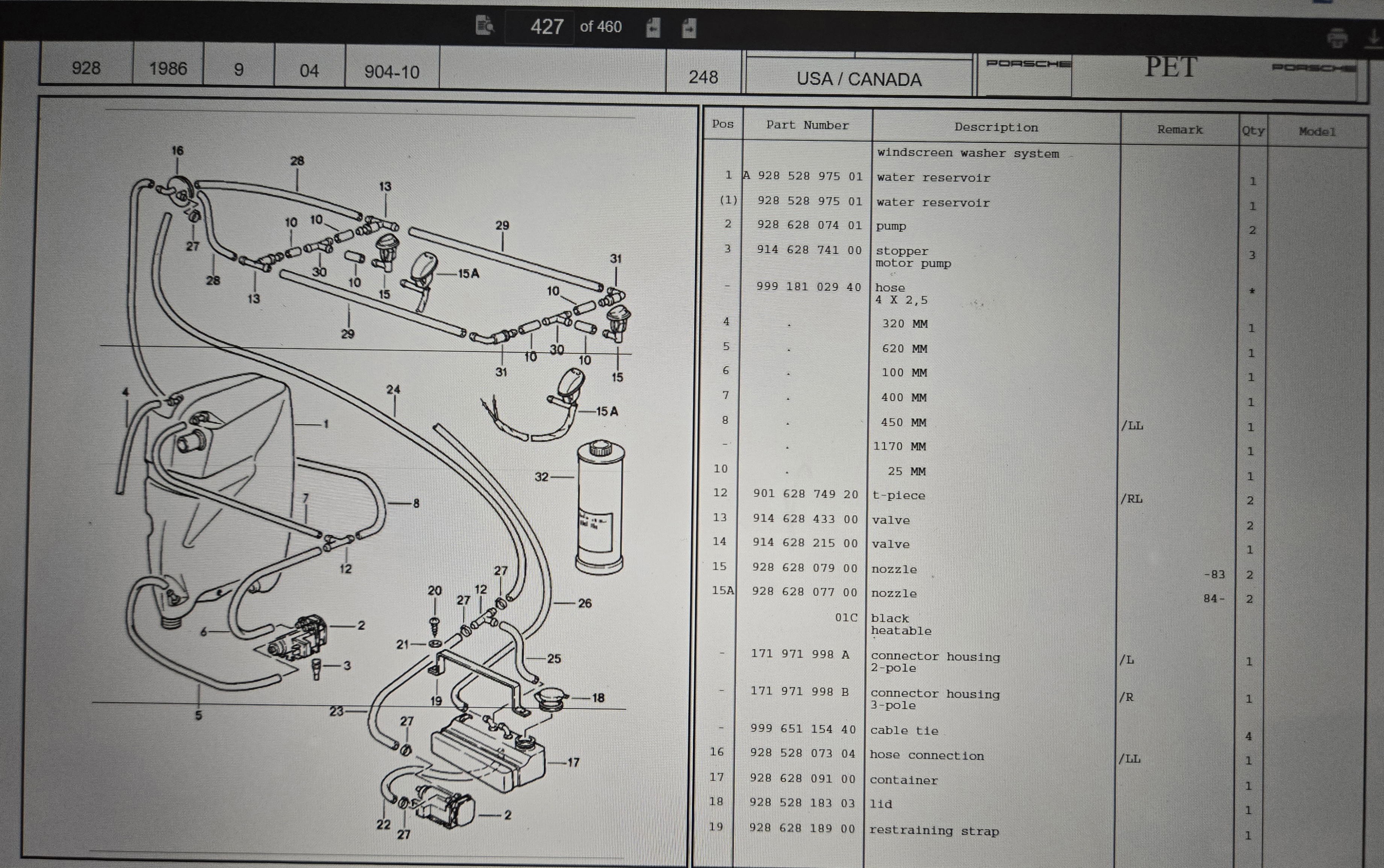

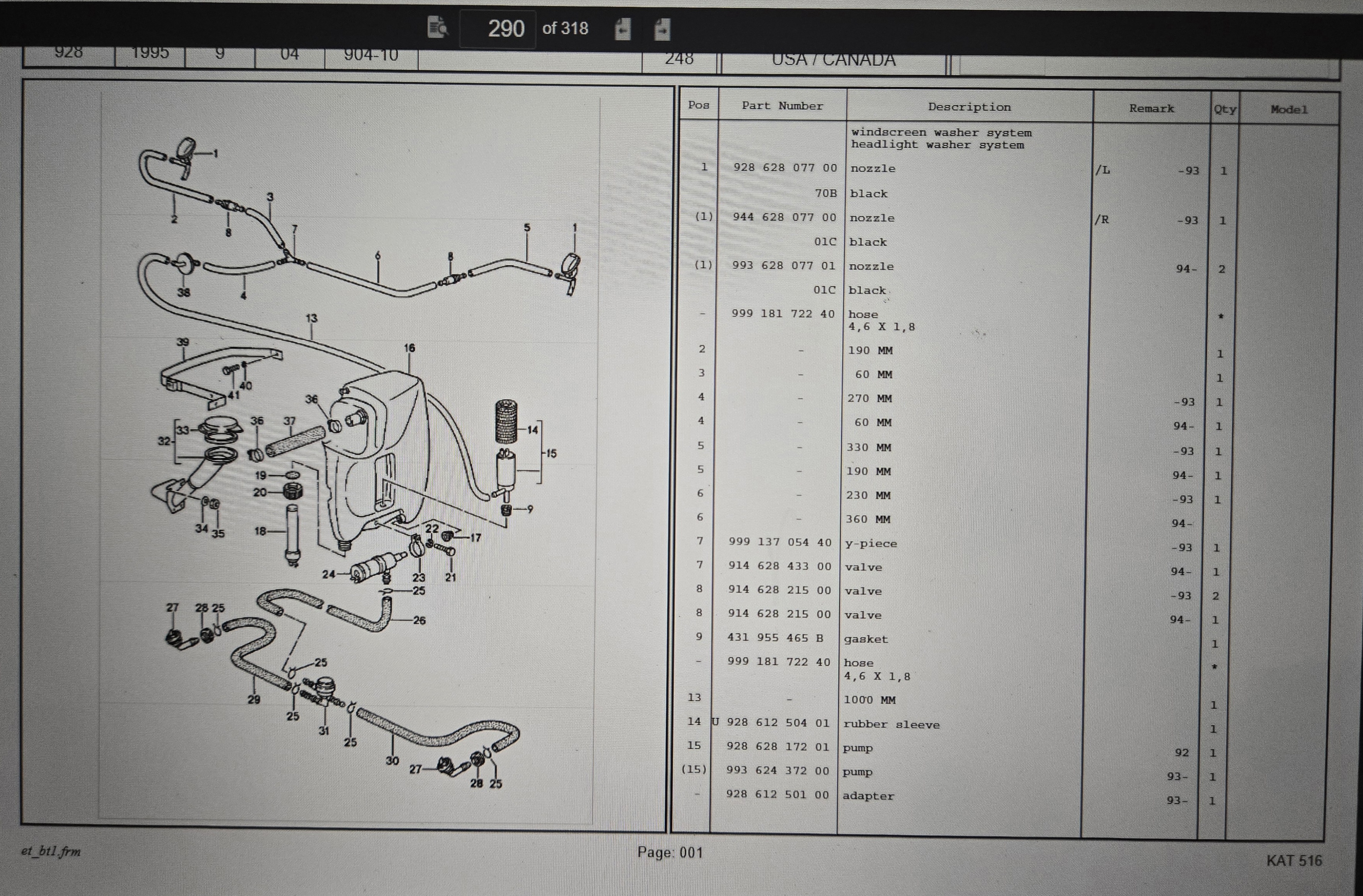

Me? No. Wash tank is plenum volume for coolant for intercooler.
As for wiring...
What I would do is make a 5-foot (ish) extension harness from the plug connector for the tank pump to the intensive washer pump.
Sourcing the pins and connector bodies will take some time but they are all probably on DigiKey.com.
