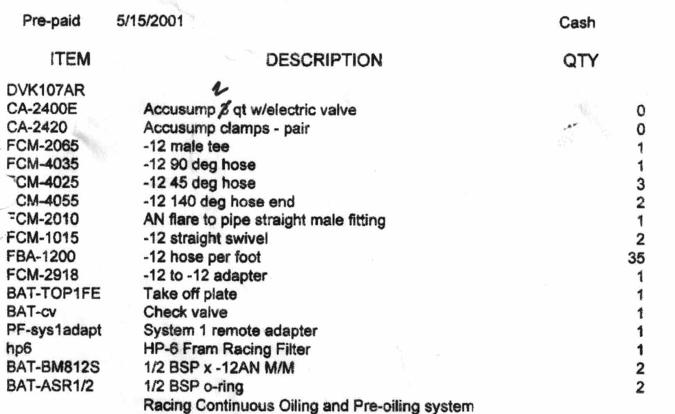

Hi friends,
I'm looking to install an accusump on my '85 for track duty. I know there's plenty of controversy over the best way to keep oil in the right spots, believe me I've read them all over the last few weeks while researching this. I feel like an Accusump set up, along with good quality oil and a reasonable rev limit, will be my best approach for now.
That said, is there a complete A-Z kit with all the bits and pieces needed? I'm getting confused looking at all the parts listed under an Accusump search. I know I need a 3-qt reservoir, an oil filter adapter, and a way to trigger it if pressure falls below 30psi, but... is there a kit with all the bits and pieces I know I will forget? If not, can anyone give me a parts list to get it done with a minimum of "oh shit we forgot the xxxxx" action?
Thanks guys!
Brian Flanagan
