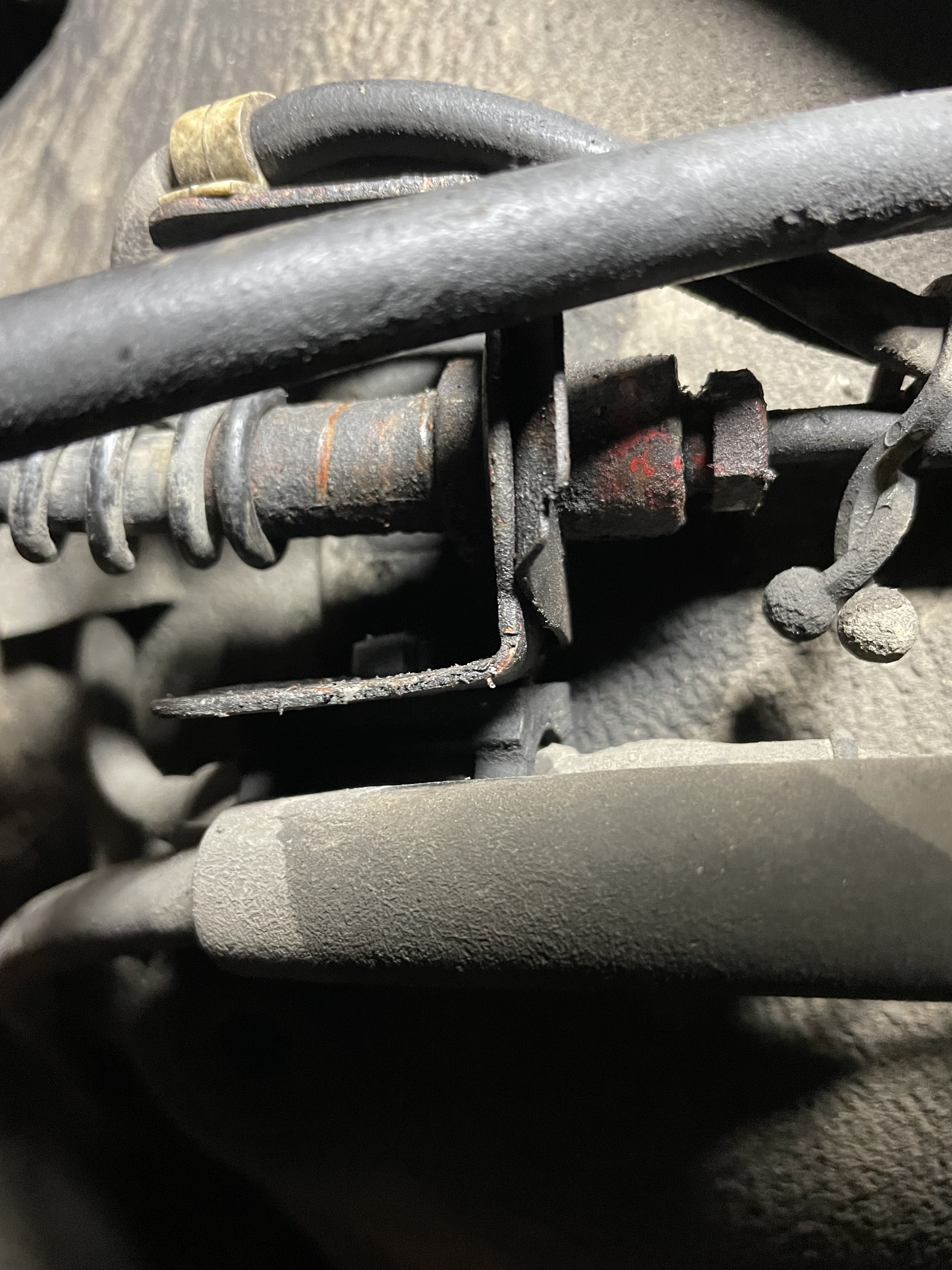

My first mistake was trying to disconnect the Left side hose from the hard line with a Combination Wrench (like Dwayne) instead of a Line Wrench and rounded the nut. I then bought a Line Wrench set. But, too late. Nut is too rounded. :banghead:
I tried PB Blaster and even ATF/Acetone mixture before hand, to no avail. I cut the rubber line so that I can at least remove the caliper, rotor and shield on the Left side only. (I have not touched the Right side at all yet)
The rotor took a least a hour and half of banging and wedging/shaking to finally release. What an ordeal! Before I attempt the Right side, what can I do to disconnect remaining hose from the Hard line without further damage to the hard line connection? Or am I fucked?
This is before the 11mm nut was rounded.

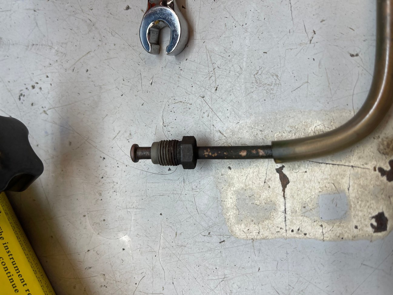

Can the mounting bracket be removed from the body to get better access or is it welded in place? I removed the holding clip also. But that can be reinstalled, if necessary.
I assume that this is similar to what the end of my hard line looks like correct? (image stolen from a thread by Seth)

Rick, you need heat. Extreme but carefully-targeted heat.
https://boltbusterinc.com/
Some folks have apparently gotten good results with Chinesium Harbor-freight quality induction heaters.
A ‘hand torch’ is disrecommended; it will melt other stuff before the union nut gets hot enough.
Beg, borrow, buy, or steal an induction heater and then report back for safety and process tips.

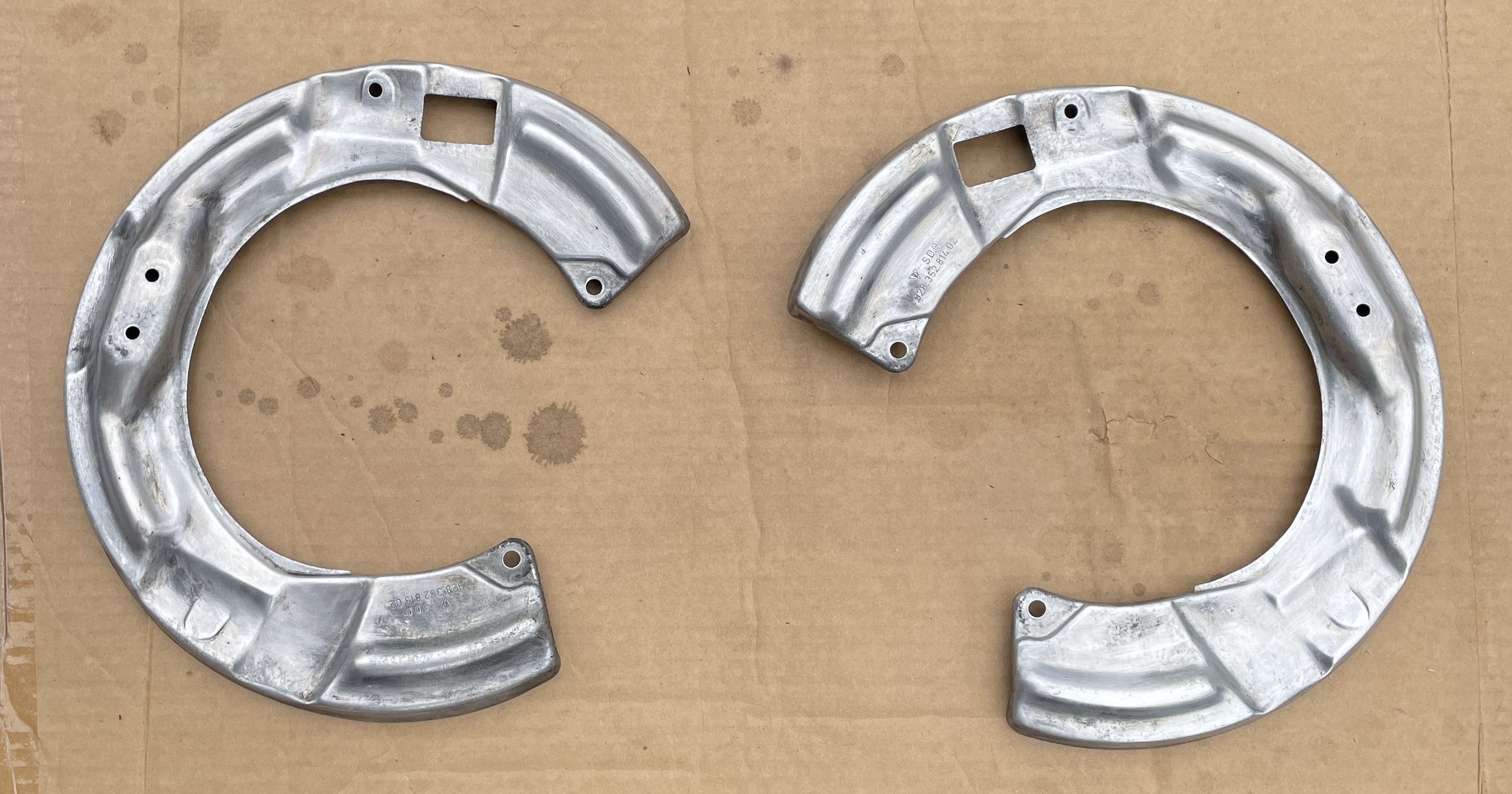

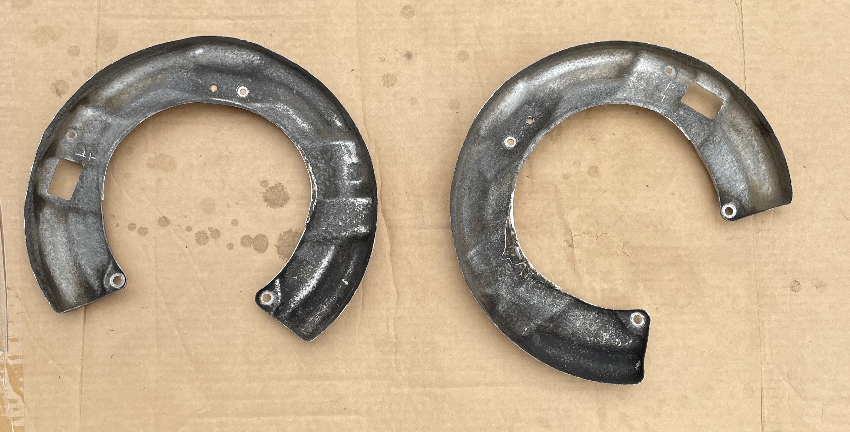

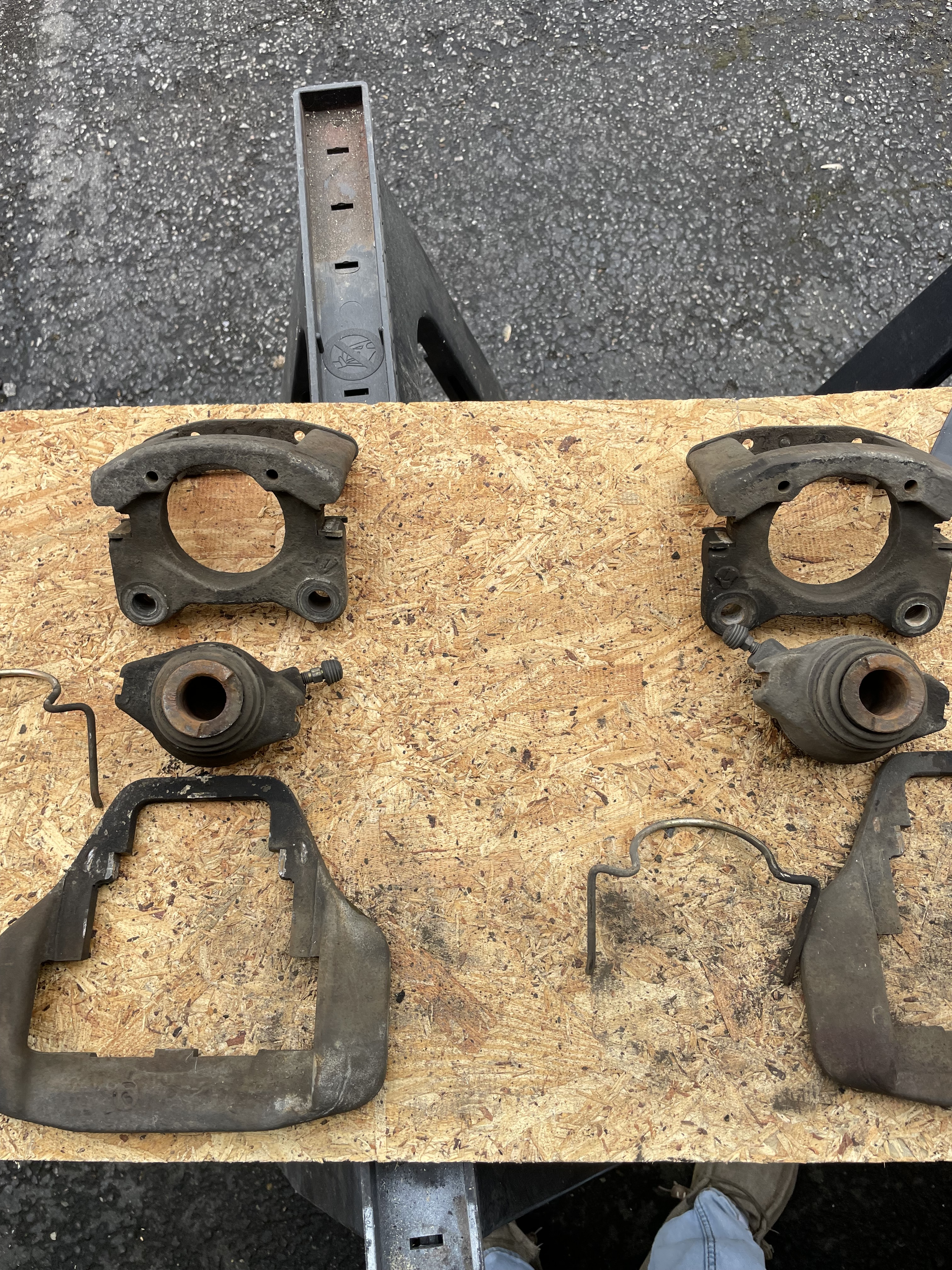

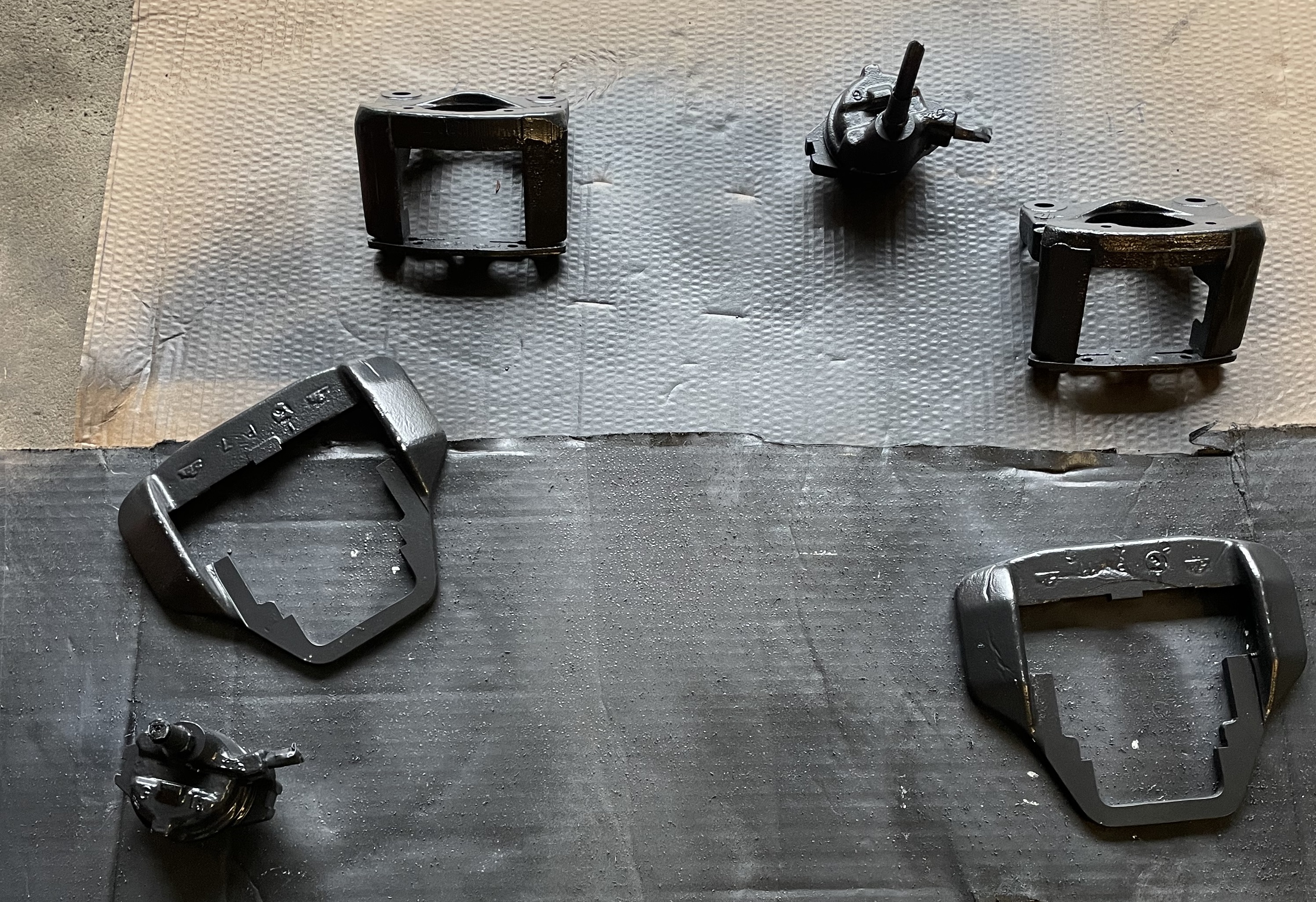

Disassembled, cleaned and painted the calipers and shields this weekend. I didn't acid bath or have them sand blasted. Just cleaned and wire brushed them the best I could. I'm not the greatest or most patient painter. But, I think they turned out pretty good.
Here's what I used. Black for the calipers and other little parts and silver for the shields.
Some before and afters.
I didn't take a picture of the shields after the paint and clear coats. They turned out great. (I'll add the painted soon)
After cleaning
Calipers (Disassembled based on Dwayne's write up)
After painting and clear coats.
I'm pretty slow. This took the whole weekend!
Now I have to wait to reassemble everything once I get my order from Roger.

Little hick up in this rear brake refurbish. The small rear left hard line is unavailable from Roger at 928Rus at this time. Maybe a 12 week wait from Germany. I don't really want to wait that long if I don't have to.
Are good condition USED hard lines possible?
Can these be made by a shop? What kind of shop would do this?

Thank you Gary. But, the male connection at one end of the hard line is damaged (rounded nut). Can just these connectors be sourced?
Wouldn't I need a special tool to flair the ends?

WyattsRide wrote: Thu Apr 03, 2025 11:55 am Can just these connectors be sourced?
Yes.
https://belmetric.com/fittings/brake-lines-fittings/
M10x1.0 IIRC, but check that.
WyattsRide wrote: Thu Apr 03, 2025 11:55 am Wouldn't I need a special tool to flair the ends?
Yes. It's a bubble flare.
Belmetric also has "bend it yourself" pre-assembled lines. I don't know if any of them are the correct length nor how hard the tubing they use is to bend. Shipping might suck if long.
https://belmetric.com/4-75mm-brake-line ... ed-tubing/?
If none of those are close to the correct length...
If I have fittings left, I can make you one with easy-to-bend tubing. I will need the exact "straight" length. You will need to bend it to match your old one. Should be less than $50 including ground shipping if it fits in a "tube."

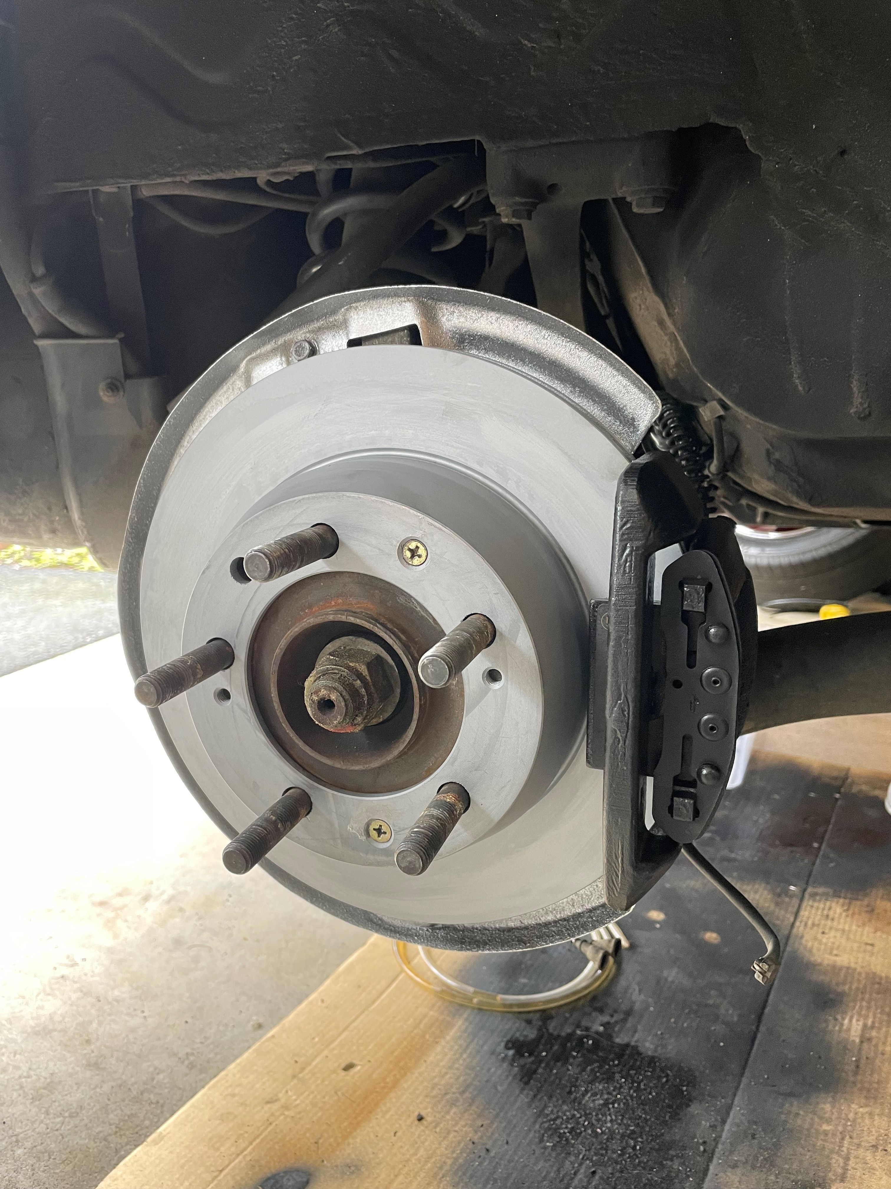

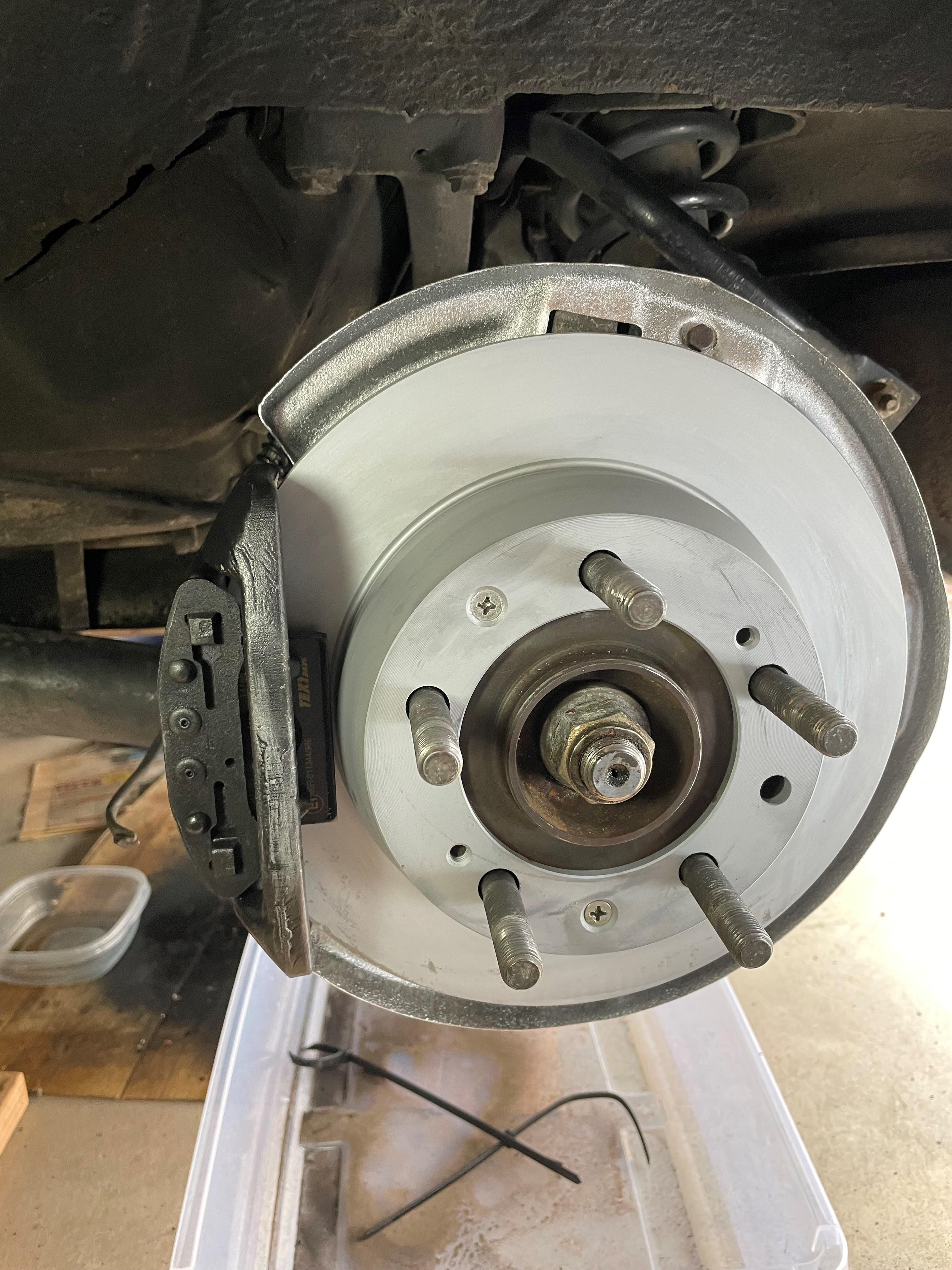

This weekend I rebuilt the calipers, attached the hard line on the left side and put everything back together. Now I just have to bleed the lines.
Question though. The new rotors have a coating on them. I cleaned the surfaces with brake cleaner. But, I did not try to remove that grey coating. Should I have?
Also, the sensor ends are broken and will not stay in the pads. Can I just leave them loose for now?

The 85 is back on the road and braking beautifully!
Thanks to Ed R (linderpat) for helping me bleed the brakes. It took a couple sessions to finally get all the air out. I'm lucky to have Ed close.
Thanks to Dave and everyone else for the online help!
