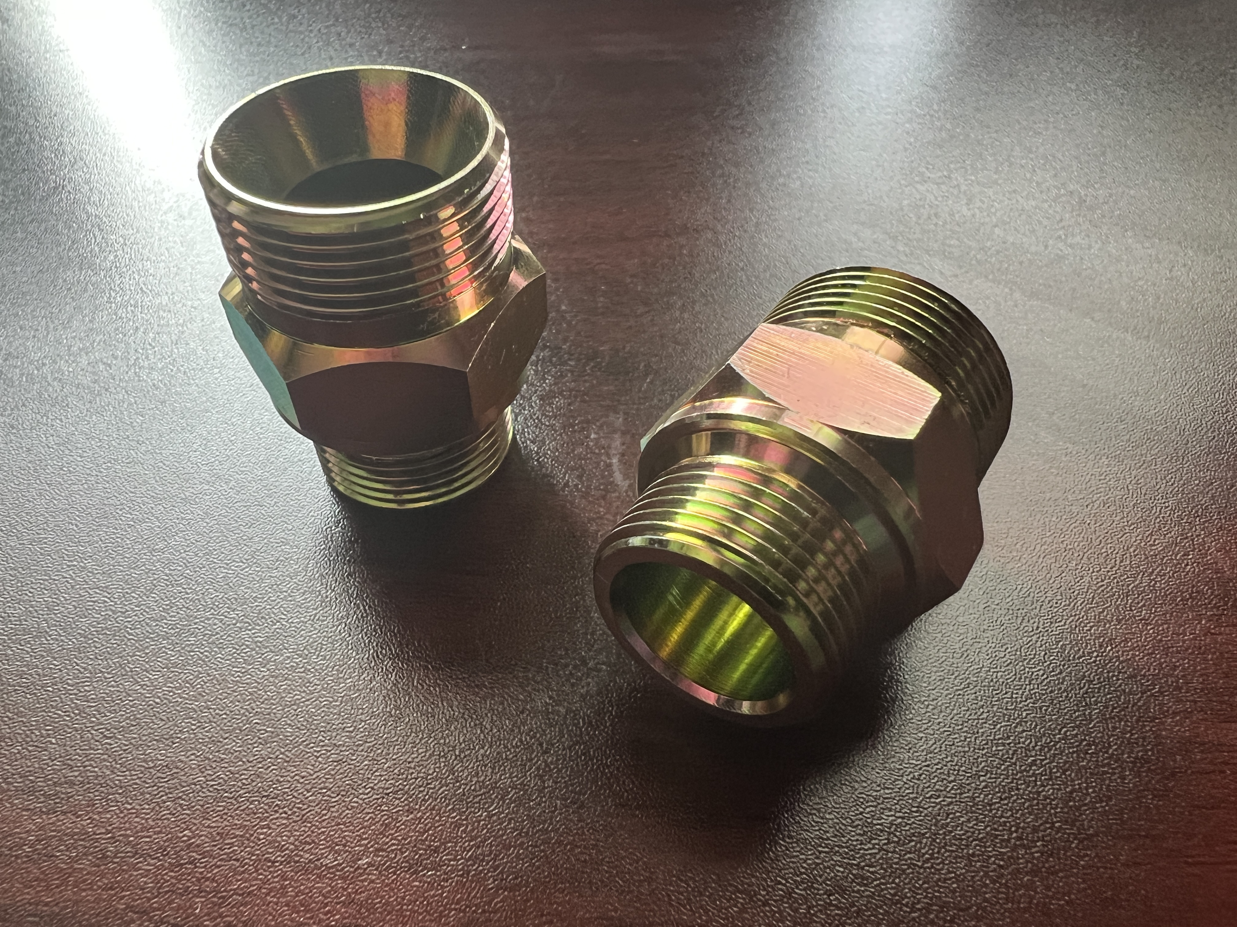

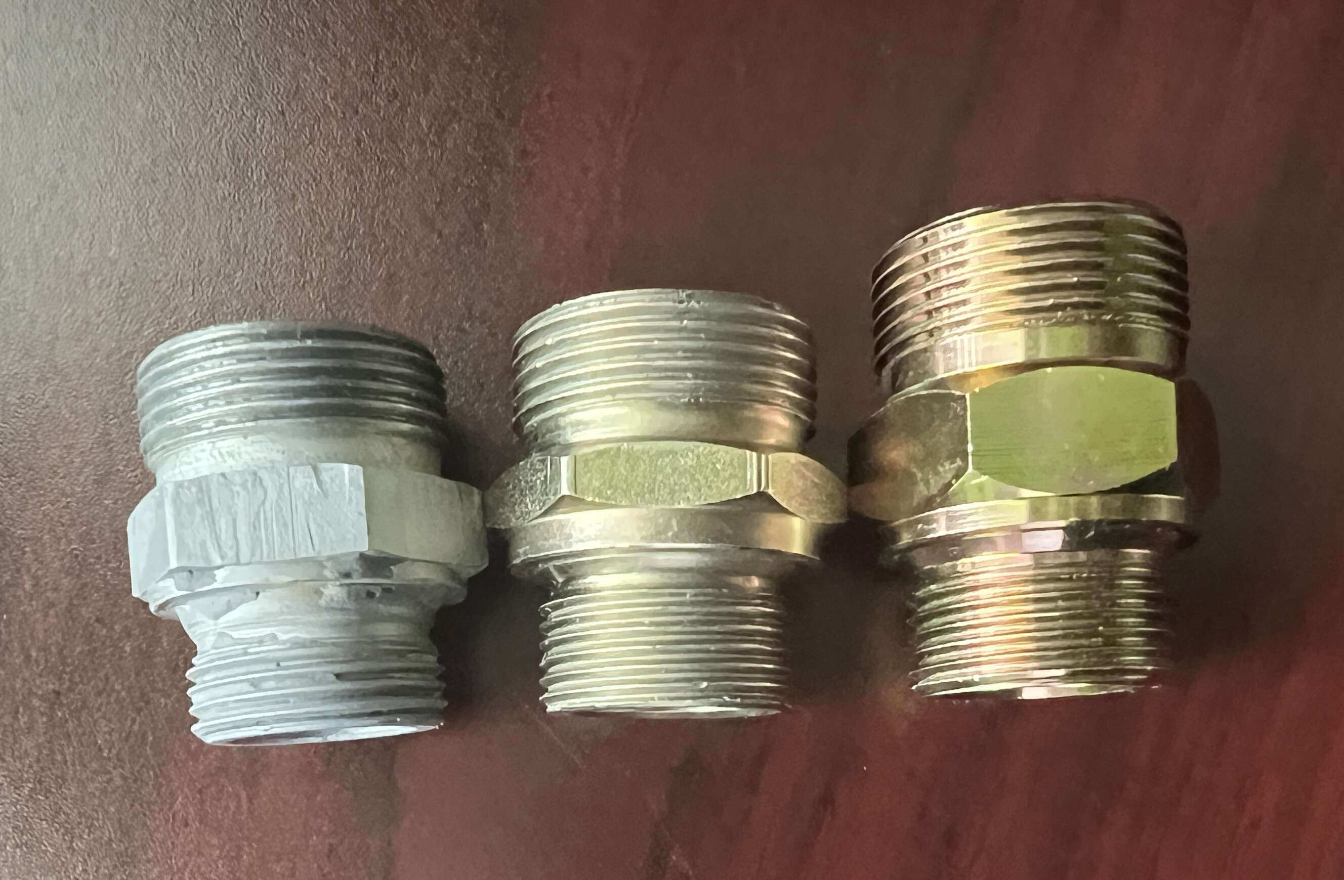

On Rennlist there have been numerous threads about the oil fittings that screw into the block and the problems they cause when they break loose. Part of the problem is that the wrench boss is too narrow to get a wrench on them to counter hold and when people yank on the oil line to loosen it the fitting breaks loose from the block.
Below on the left is the original fitting that was on my 86 block. You can't get a wrench on it. In the middle is Porsche's current replacement version. Even thinner and you obviously can't get a wrench on it. On the right is my new design.
I had one of the factory fittings hardness tested and chemical tested @ a local lab so that I know what material to make the fittings out of. This alone cost over $700.
In addition to the new fittings I'll be also selling a wider sealing ring to help repair the damaged threads and helping in adding a cleaner installation.
The overall solution is to JB weld the fittings to the block, and if you go that route being able to counter hold them is still a good idea when loosening the oil lines. (I actually had both of mine break loose after JB welding them in. It is very difficult to get the threads perfectly clean with what ever solvent you use.
Depending on where you search, the Porsche fittings sell for $25-$30 each online. I have this initial batch priced @ $60 per set plus shipping. They should be ready for shipment starting on the 20th.

How bad are the threads in tbe block?
If they are good enough to hold normal tightening, I wonder if gel type Tread locker/sealant red might be better than JB weld.
You would have to get the threads really clean.
#292899
N_Jay wrote: Sat Jan 11, 2025 9:23 pm How bad are the threads in tbe block?
Either way it's best to be able to counter hold when loosening the oil lines as they need to be pretty damn tight to keep from leaking and you cant do that with the factory fittings.
#292902
maddog2020 wrote: Sat Jan 11, 2025 9:26 pm
Not arguing that. Just thinking if it comes loose, a second repair after thread locker is easier than trying to clean up JB weld.
#292903
the threads are usually good, what happens is that part of the last thread breaks off, and takes a chunk of the sealing surface with it. Others have tried the gel thread sealant and had to go back in with JB weld because of the thicker consistency. Personally I cringed when I 1st read about using JB weld but quite a few people weighed in that is what they were doing. This is where my wider sealing rings come into play & that is another discussion. lol
