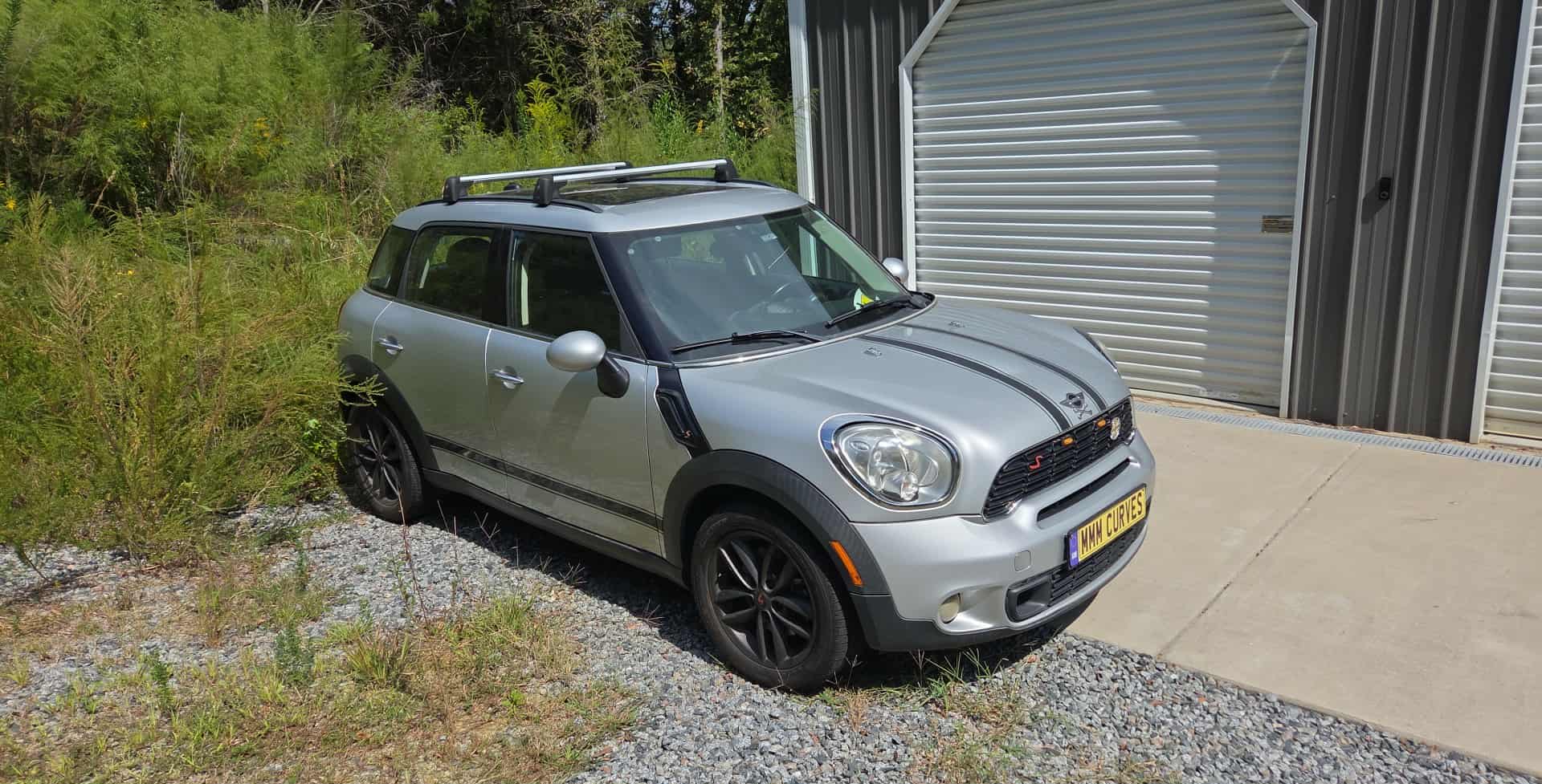

Well, the Mini is here.
Will be a few weeks before I have time to start digging in to it.
It is in decent shape, but not perfect.
Engine compartment was very dirty, and it wouldn't start, but no telling why yet.
