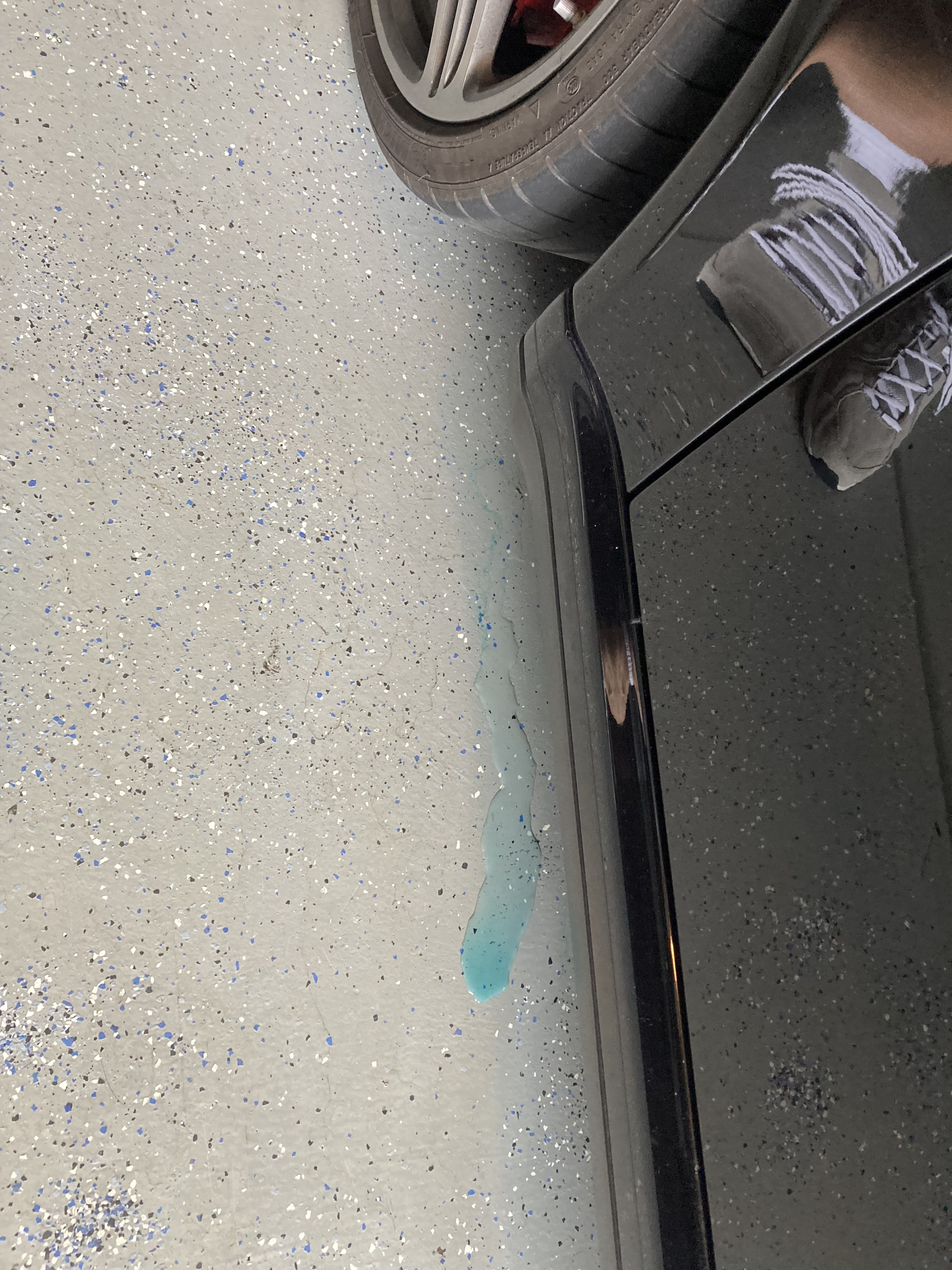

woke up to this I'm thinking window washer fluid. any takers on what it might be?
By wsh
#339189
Could be window washer fluid
My 07 GT3 did that
By Skyhawk172
#339203
Thanks all I don't think I have used the washer for my windows in 9 years I have owned the car LOL
By wsh
#339206
It's been a long time, but IIRC the dealer (Hennessy) said it was some gasket/grommet between the tank and the filler pipe
Was going to fix under warranty but since I never used it they just drained it to ~half and never a problem again
#339214
A common failure mode is that the washer hose section that flexes whenever you open and close the frunk lid gets abraded by the plastic frunk area splash guards.
Open your frunk and look in front of the left (driver/port)-side lid hinge.
#339406
worf wrote: Fri Apr 17, 2026 6:53 pm A common failure mode is that the washer hose section that flexes whenever you open and close the frunk lid gets abraded by the plastic frunk area splash guards.
If it's anything like the Cayman's it's a poor design that seems to fail pretty quickly.
