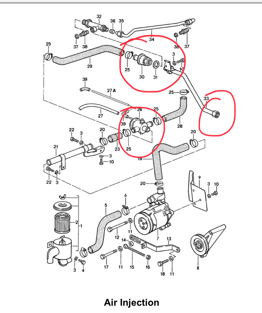

Re: Name that squeak (belts, timing belt, bearings, mouse?)
Posted: Sun Feb 02, 2025 2:07 pm
by worf
Since the frequency of the noise is NOT (right?) RPM dependent there are few culprits I can think of.
“Chirping” noise from the right side, aft of the front wheel, is often some part of the air pump system that has been disconnected or has otherwise become disconnected. It’s usually due to the output having no connection to aftermarket cat.
A quick test is to cut the air pump belt. But, that’s a problem pre-S4. At least when it’s not super cold outside.

ChrisZ wrote: Mon Feb 03, 2025 1:56 pm It's pretty super cold right now :-). But on an 86.5 how does one adjust the tension, is it just a loosen the air pump?
Order the ‘short belt’ from Roger that just drives the fan. It’s the first belt, so, not too hard to do.
