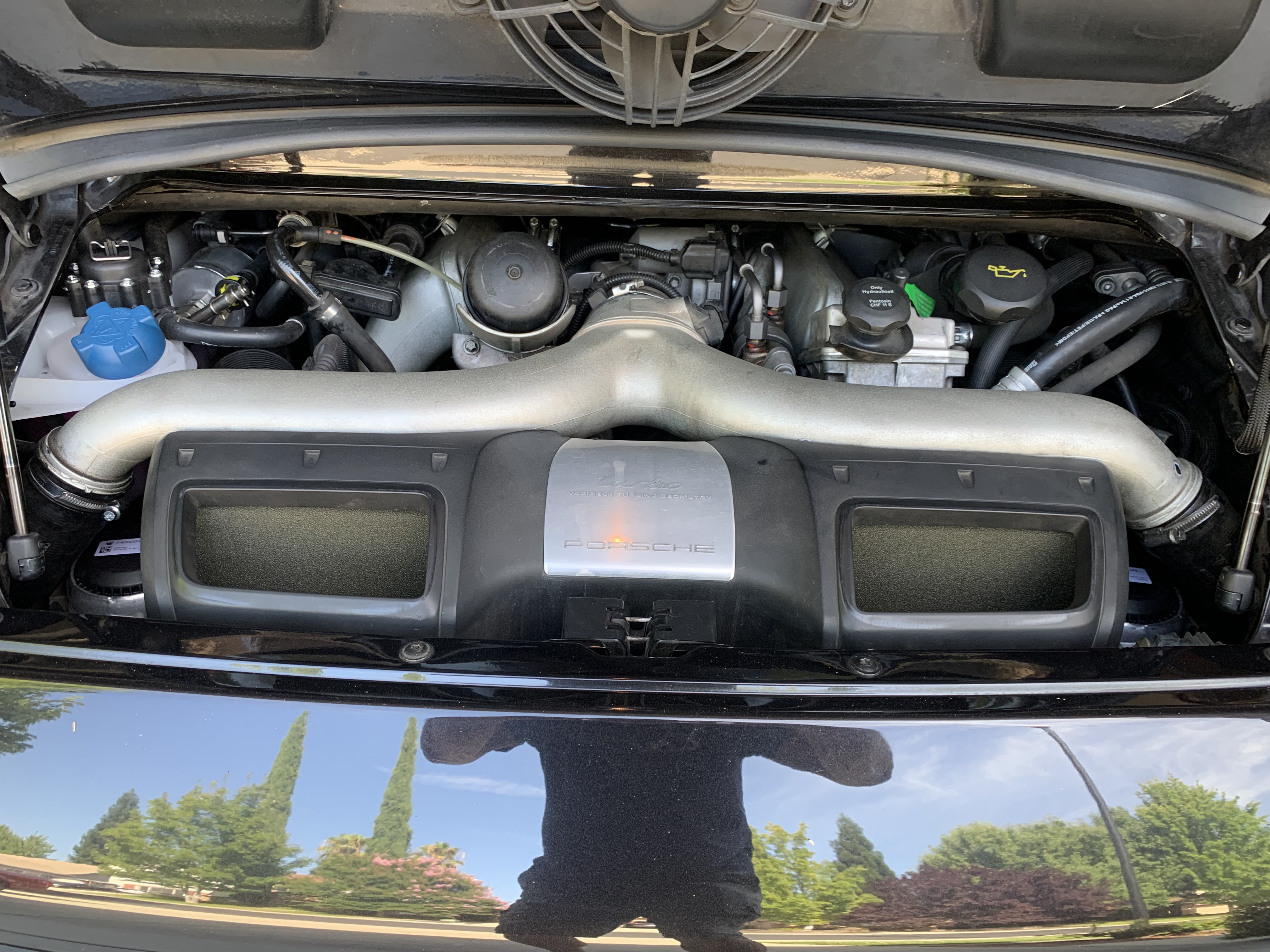

Got a quick call this morning from my Indy and tells me he has the motor pulled if I want to come and see it. Since I have a lunch date with a few Porsche friends in Penryn the wife and I will stop in and take a few pics. :thumbup:
Look Ma no pants
engine in search off a car
Edited for pictures

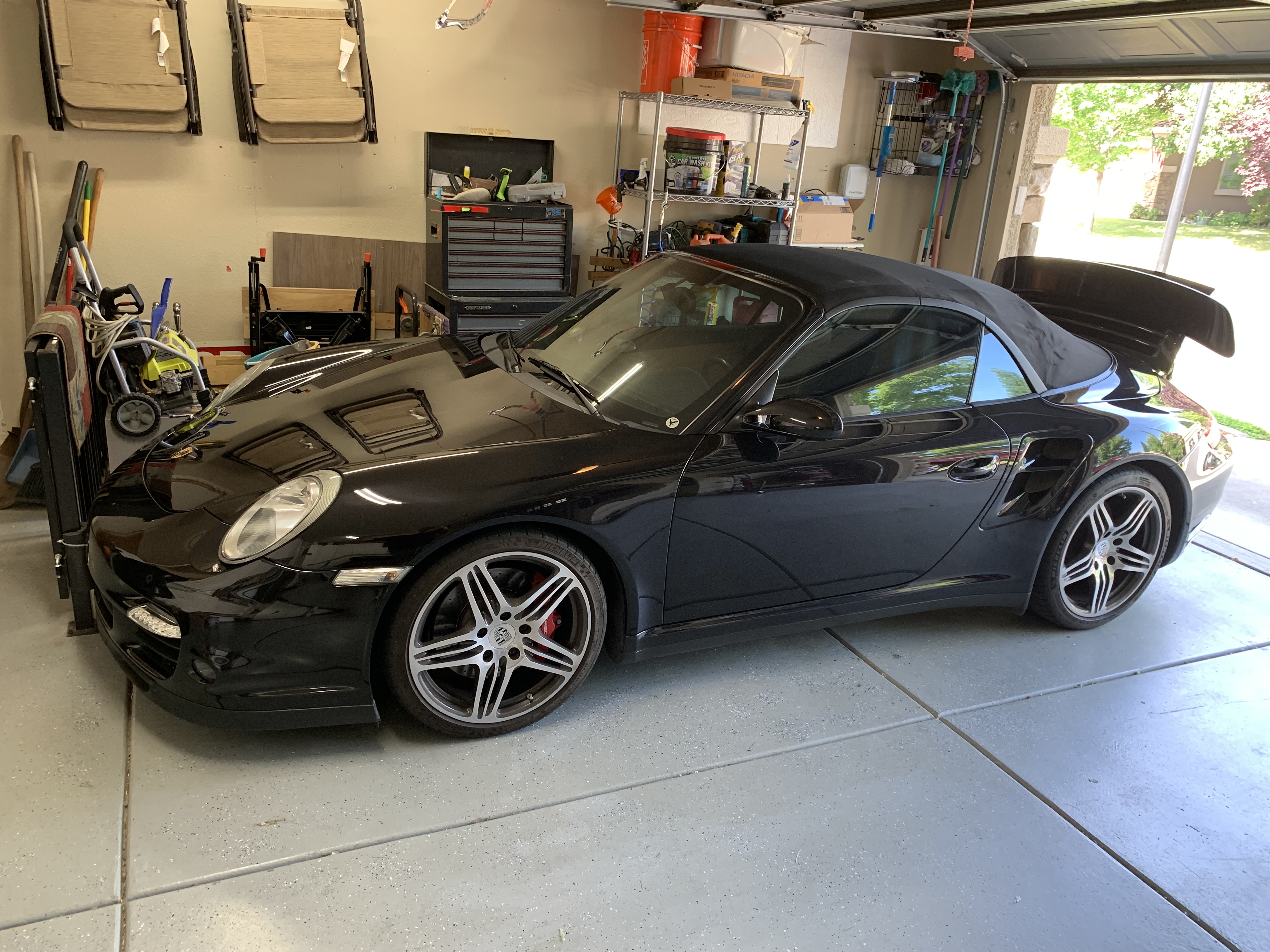

Ok got the call this afternoon my car is ready for pickup tomorrow. Now to find a nice easy Bank to rob in the morning LOL.
By Skyhawk172
#346302

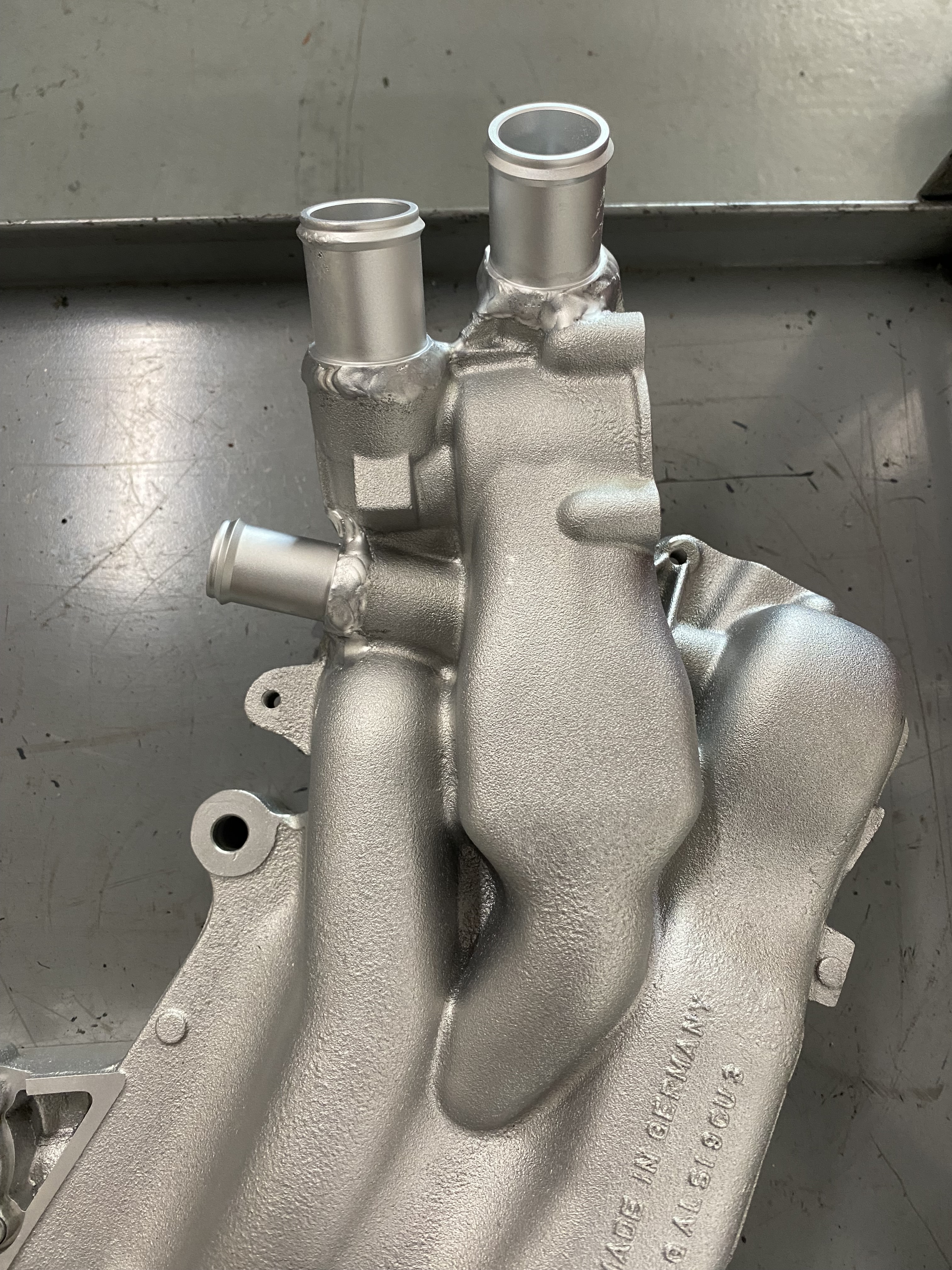

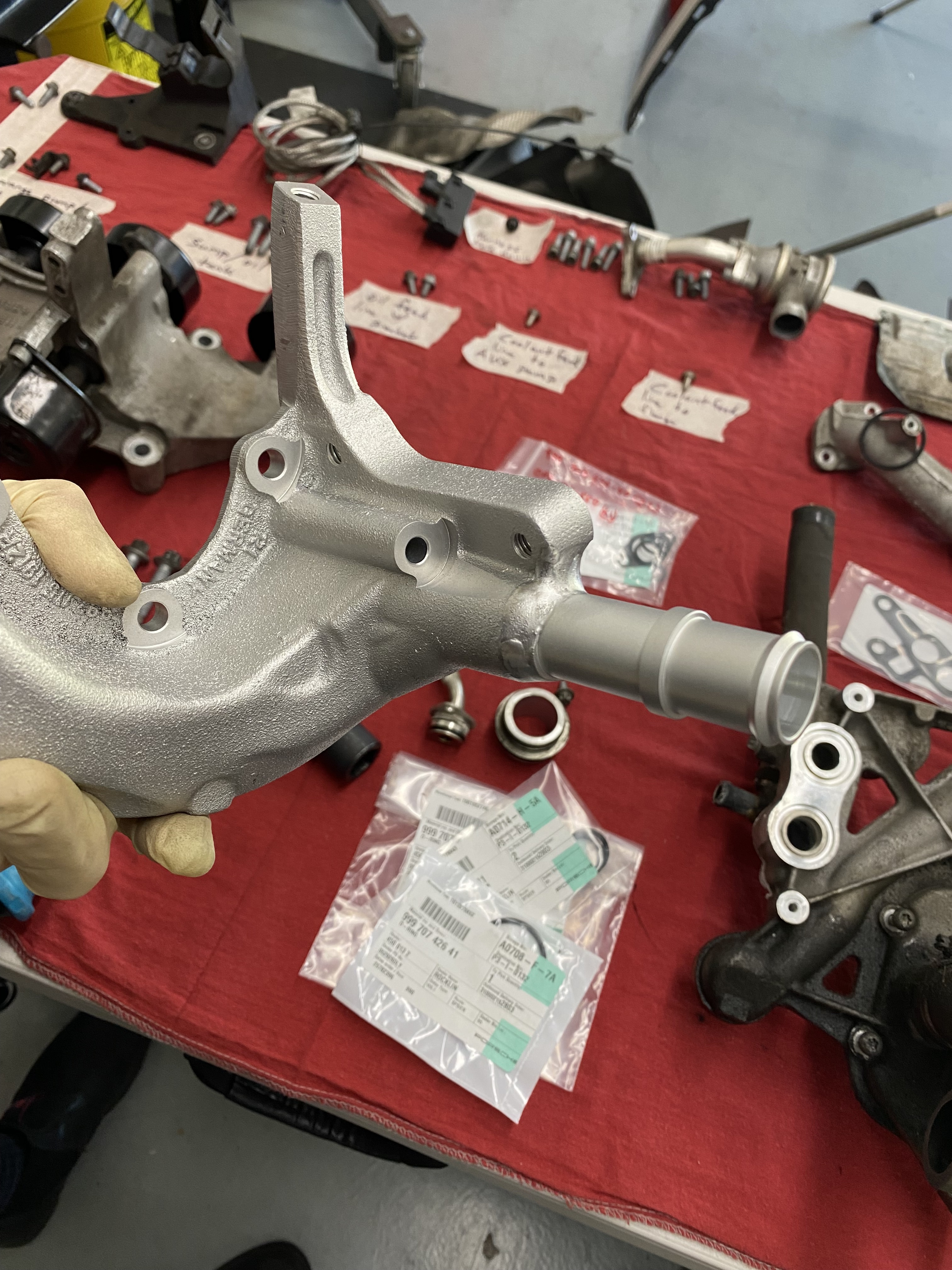

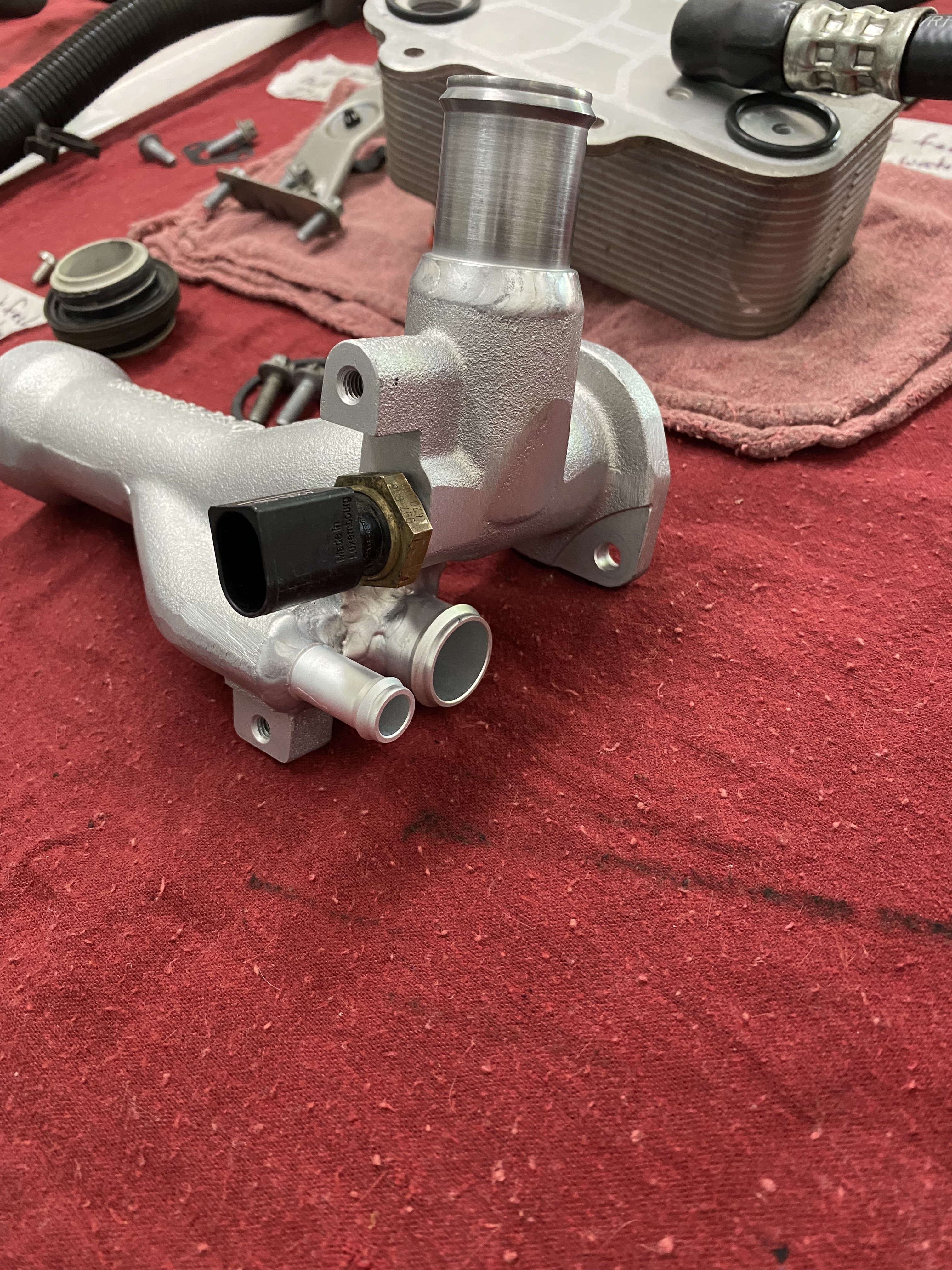

Shinny new engine parts
She's home

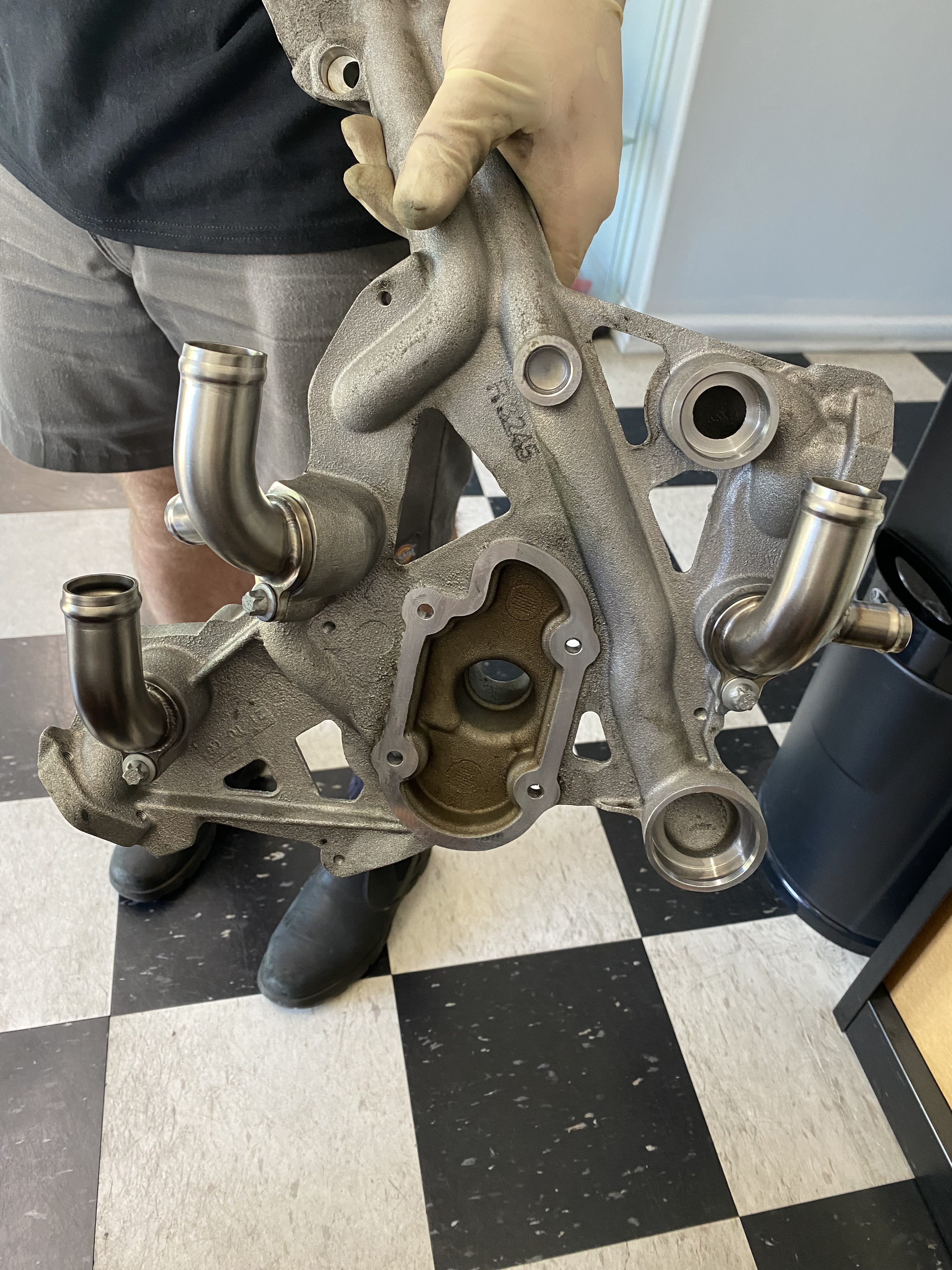

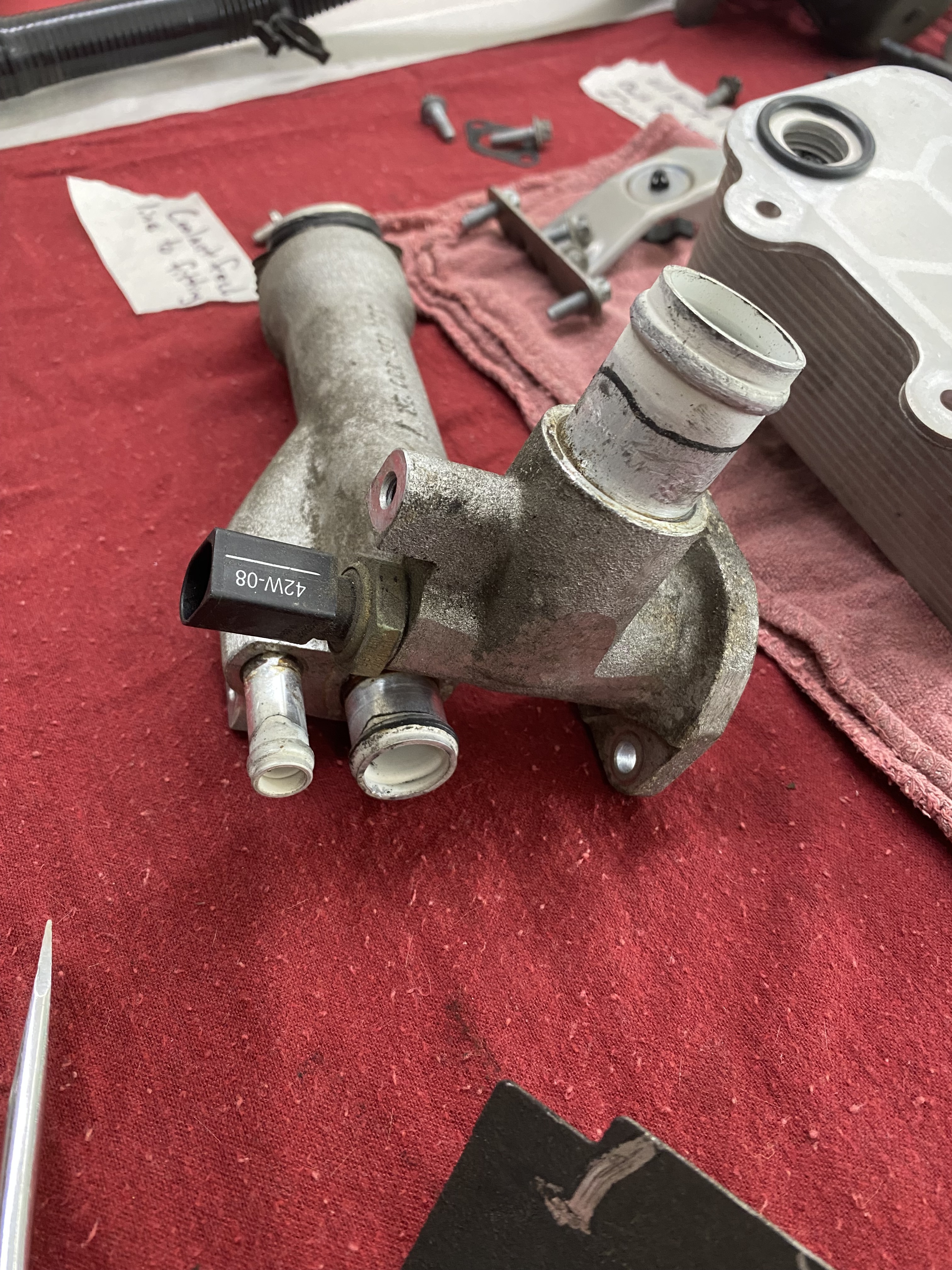

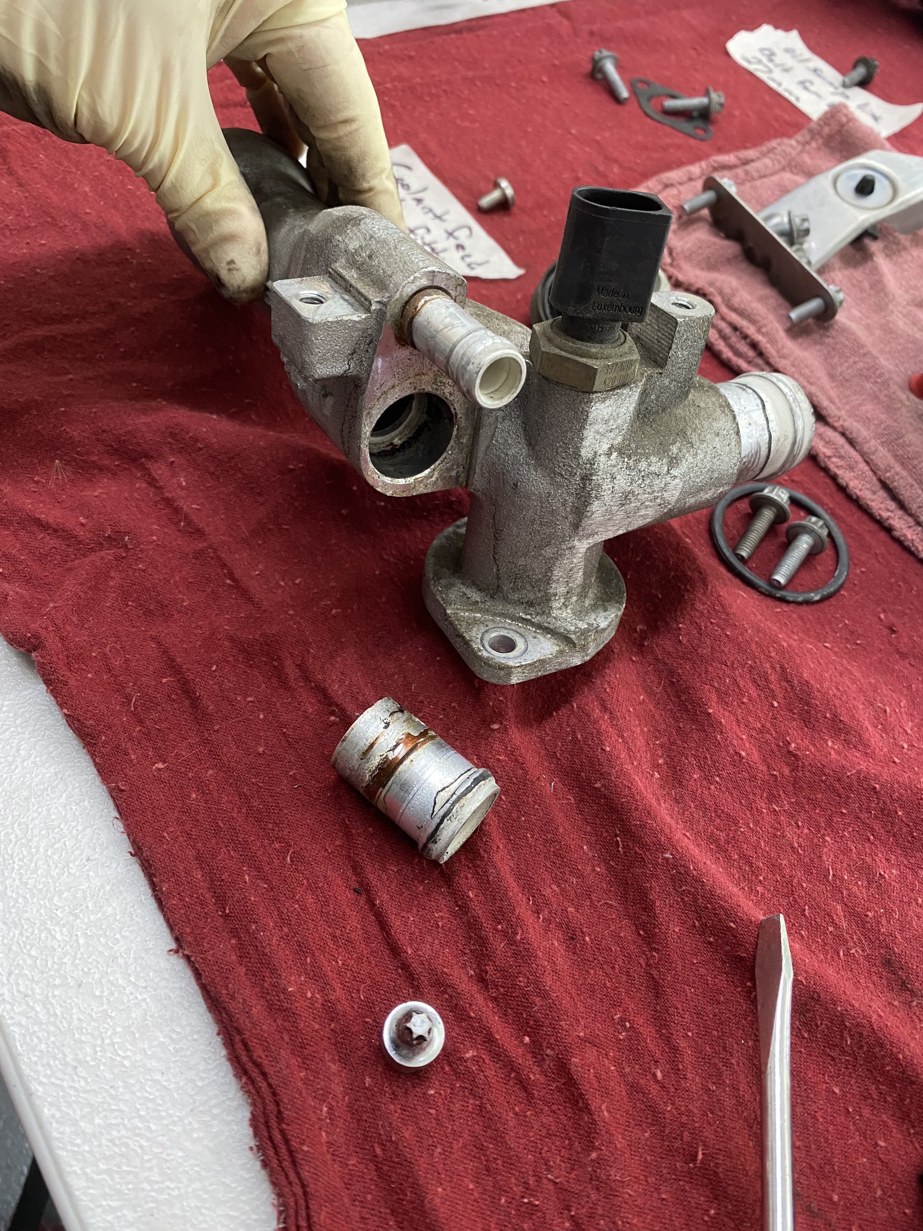

Old original coolant pipes
The old glue that failed

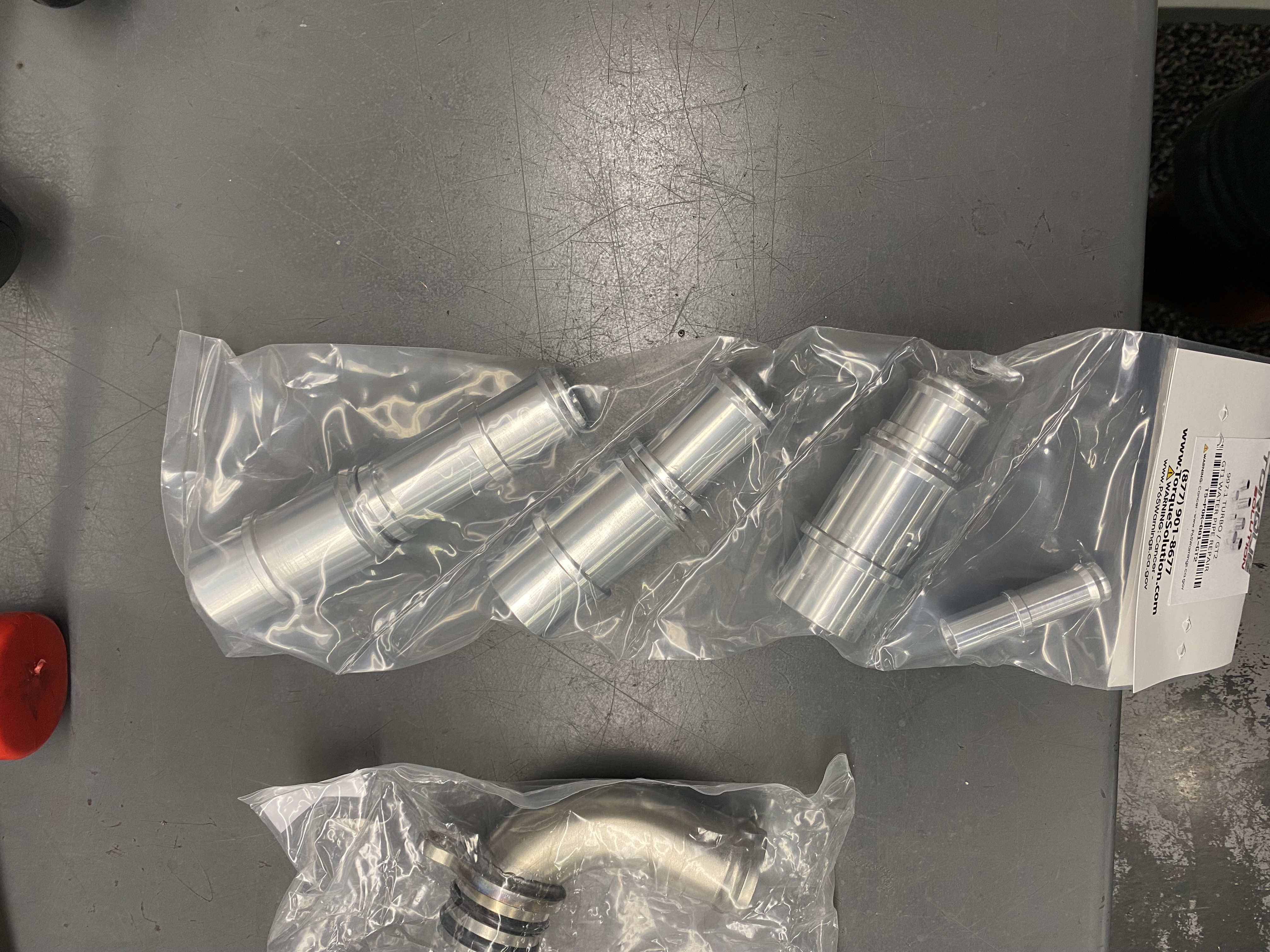

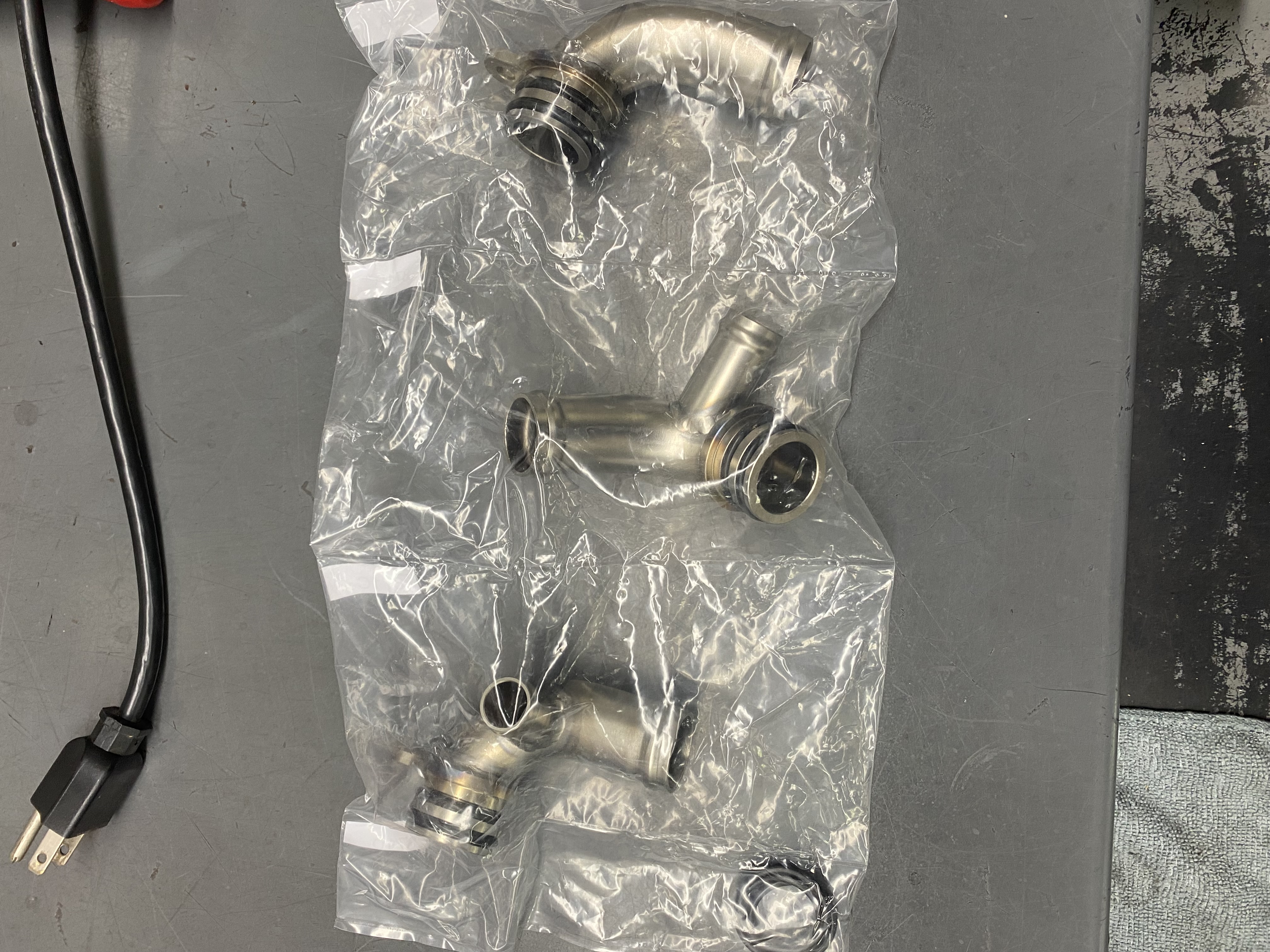

sharkwerks pipes
More new piping Aluminum instead of steel
Pipes welded into manifold
Manifold ready to be put in.
