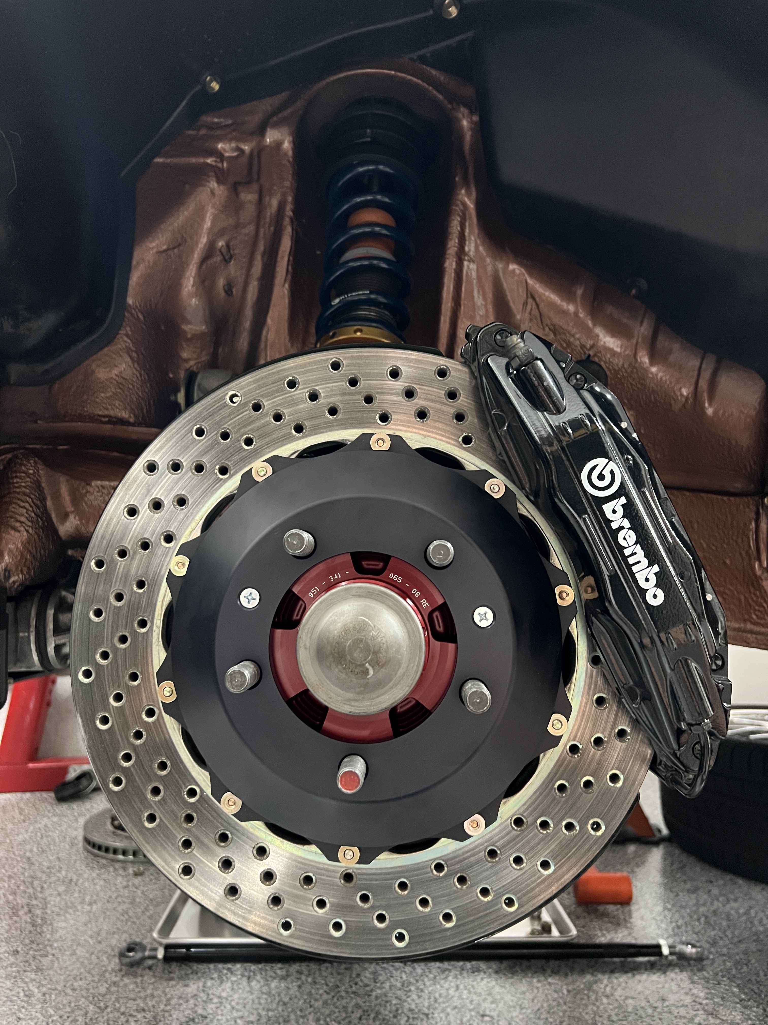

machining the spindle to the 944 profile and using the 944 hub brings the mounting face inboard 15mm on each side. I'm currently running 9" on the front but with the current setup I could go to 10's easily. My fikse FM10's fit before the spindle mod, and since I moved it inboard 15mm, and the outboard side was 15mm wider that's 30 mm and an inch is 25mm. I do have the 2.5 inch springs which would be a must as well, but an 18x10 can fit without fender mods. It's not cheap but it can be done. oh and the diameter of my tires is 26 inches give or take.
With the above mod you will be changing the distance from the rotor mounting point to the plane where the rotor fits in regards to the caliper so you'll also need to go with different rotors and it's a perfect time to upgrade to 355mm front rotors and bigger calipers. Roger has the rotor hats in stock, and you can use Brembo or stoptech rotor rings, and can choose between slotted and holed rotor rings. There are multiple caliper options out there, the cheapest being Audi A8 and Audi S8 calipers which can be found on ebay used from time to time. Brembo also makes a bolt on version with spacers but I'm not sure about the cost or part numbers. There are complete brembo kits and then you could swap out the rotor hat that Roger sells for the rotor hats that come with the brembo kit.

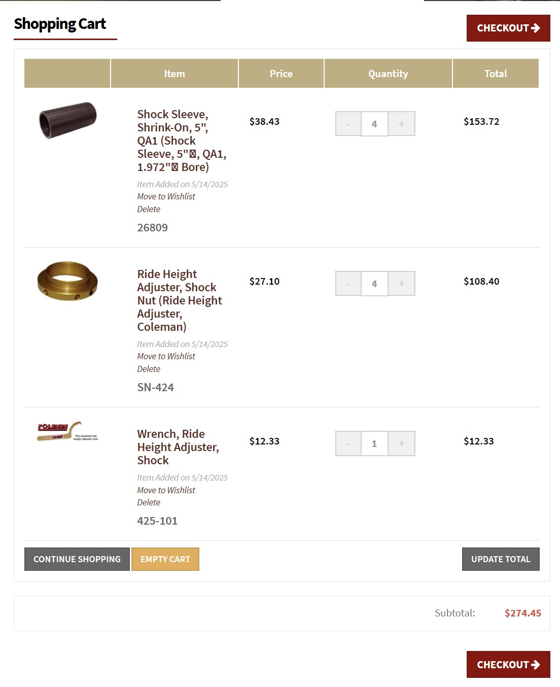

Threaded collars and sleeves are by coleman racing
When it comes to machining the spindles the 944 and 928 use the same inner and outer wheel bearings. the 944 hub just moves them closer together. You can also remove the abs rings from the 928 hubs and put them on the billet 944 hubs. I wouldn't recommend used 944 hubs as they are known to crack and that is why there are billet versions out there.

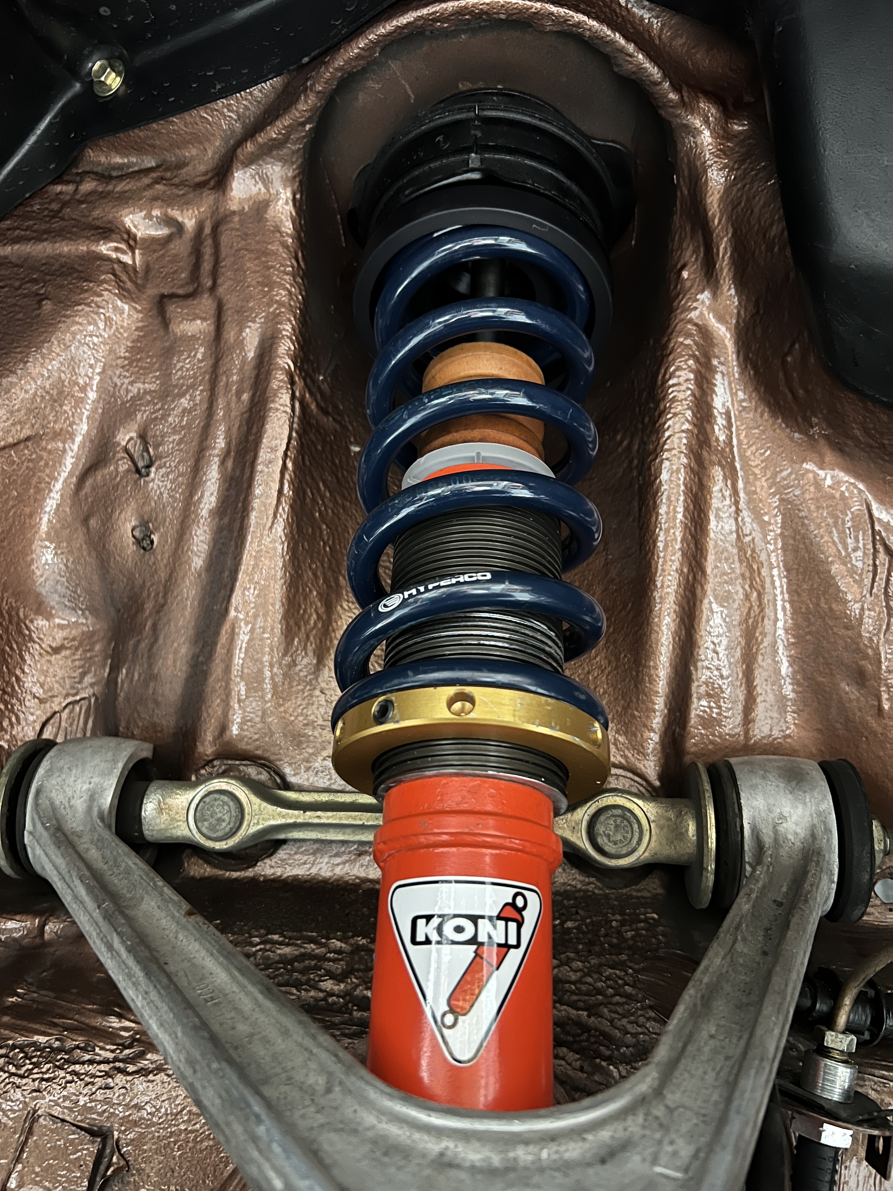

Springs are standard 2.5 ID springs and are 8" length in front and 12" in rear. I can post more info tomorrow.
