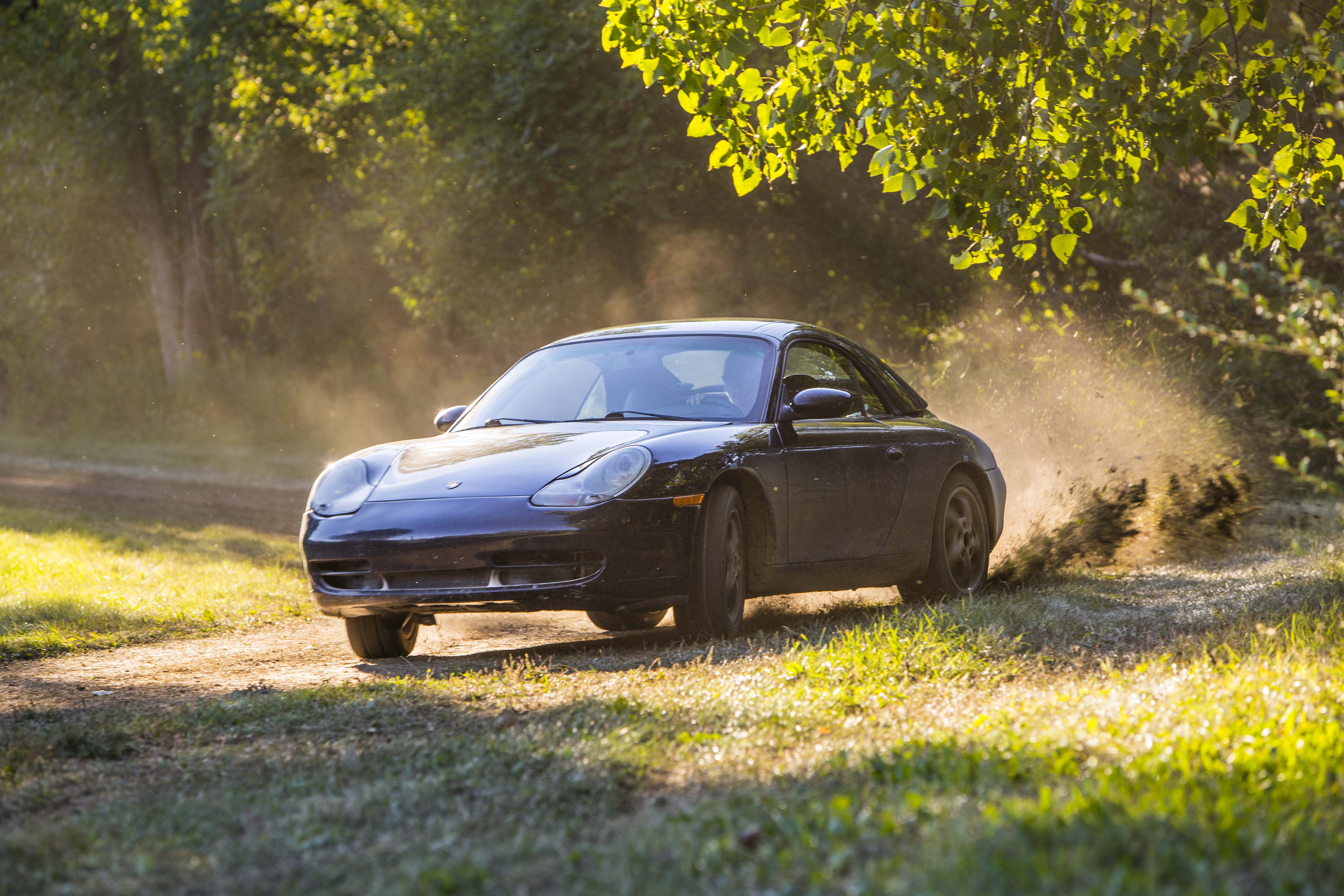

Now it is finally time to go for a short test drive. I took about 8 laps of our backyard track.
Everything checked out OK, so it was off to the gas station for a fill-up.
