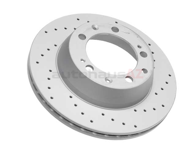

My understanding is that OEM GTS was solid rotor and I’m looking for slotted/drilled. Anybody got a quick source? I was looking at the Mercedes 400 3654 20, which I think is a Zimmermann #000-421-30-12-07-M359 for the record. But I can’t find specs on height.

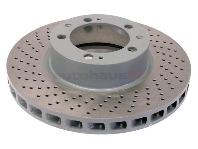

You can source OEM cast hole rotors that were used on the 965 for the GTS calipers. These are dimensionally identical to the GTS rotors. Here are the part numbers Left: 96535104500 and Right: 96535104600
Additionally, you can get the matched rears from a 951/968 part number 95135204101
