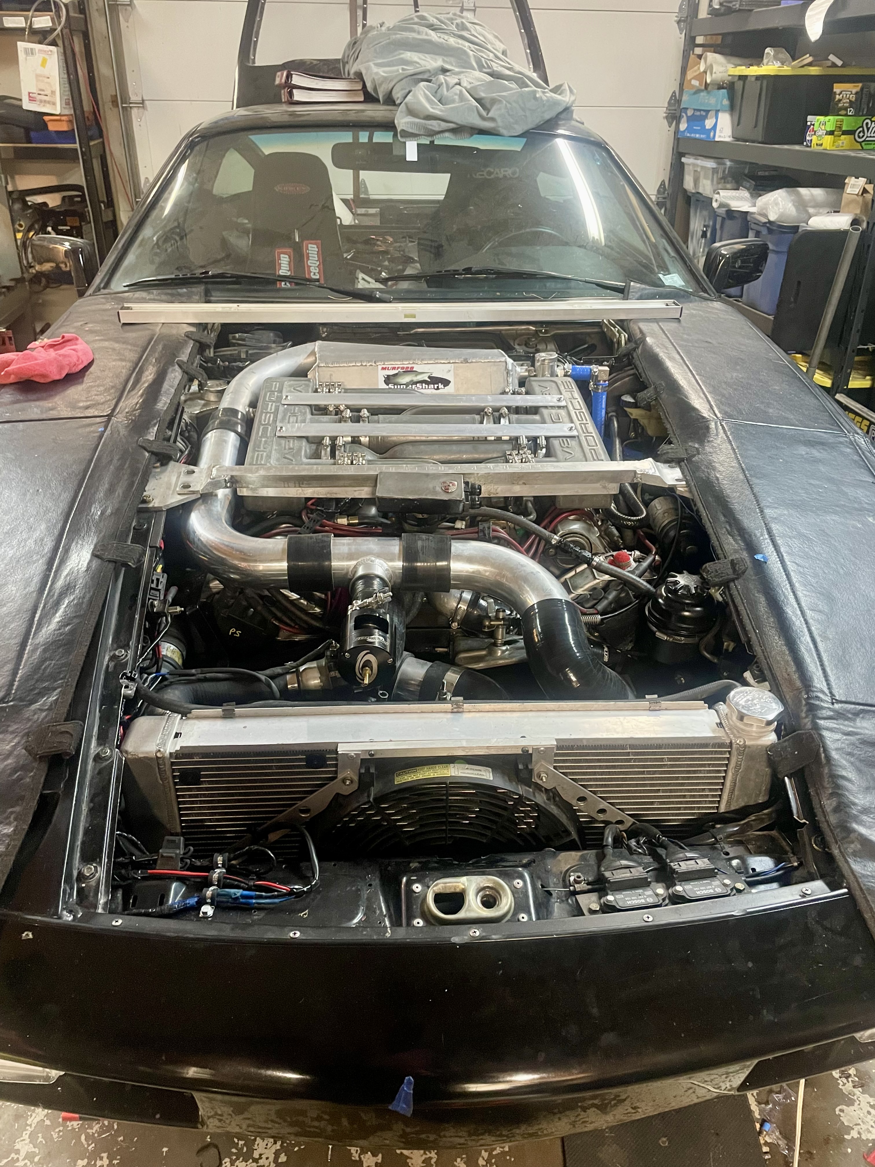

With one supercharger the car was in the 5-7 pound boost range.
With two superchargers in parallel the car is in the 5-7 pound boost range.
My only theory is that I have increased air flow but not compression, because it’s the same unit with the same specs on each side of the engine.
To increase compression I would have to put them in series, again guessing.
There does seem to be an increase in the boost curve after 5000 rpm now which was not there before. The original goal was to get another 20 mph faster punch in forth gear for the straight away. Hopefully have accomplished that at least.

Interesting to me, now that I’ve researched twin blower data (loose term because it’s all random forum stuff) and why research before you do something right?
Parallel blowers into same plenum get you same boost as a rule. Advantages are boost faster, less heat. Definitely more airflow, probably more HP, but the how much gets murky pretty quickly based on system.
If I had time I would dyno, or try the system in a serial configuration, or buy the bigger SC with the 12 rib set up that BC wants me take off his hands :)

I guess I will look at reconfiguring the blowers in serial now, and complete the arc of insanity.

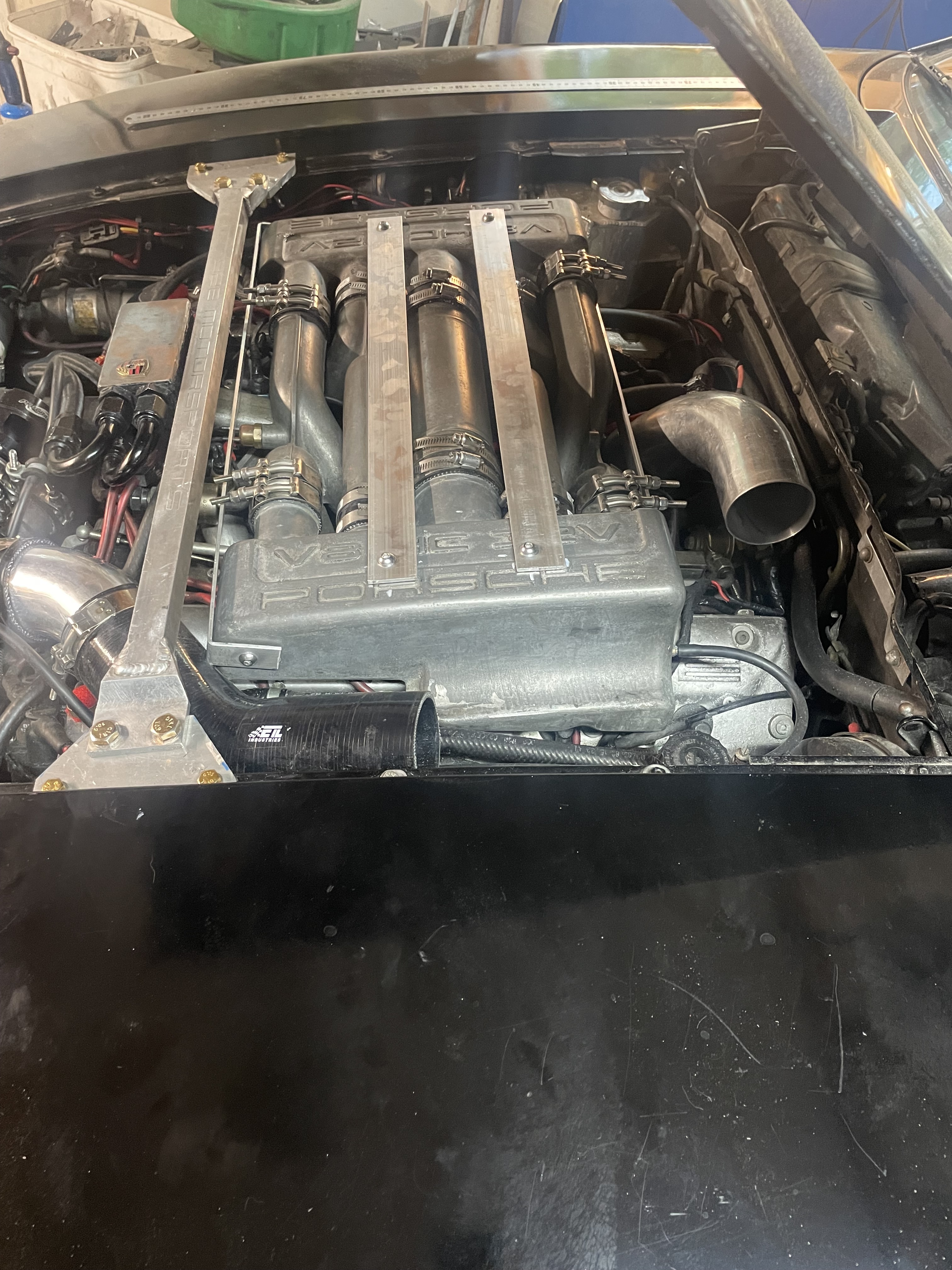

Sequencing the blowers was the key apparently.
First test drive it was obvious. The boost was 8.5 pounds by 3500 rpm. I need to remap the VE and ignition tables before I drive it again.
Obviously one P-1sc was not giving me the output that it should have on paper. Factory specs and pulley math, it should have. I don’t know.
Air temps don’t seem terrible. But i technically don’t have an intercooler in the circuit:(
